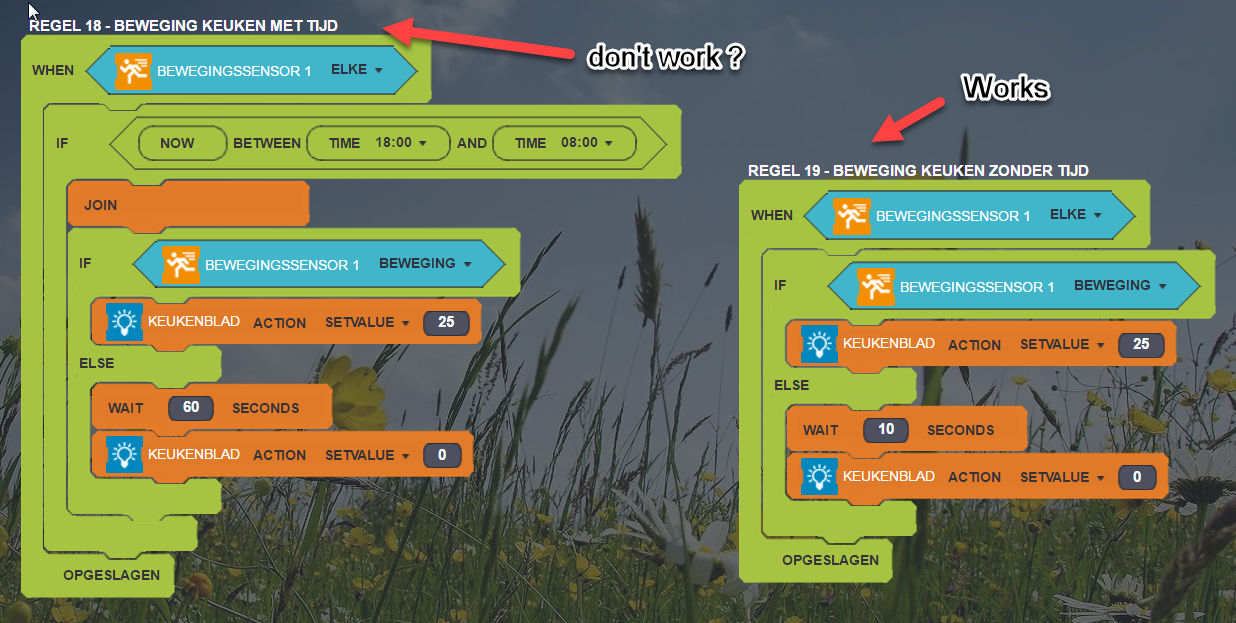

I am having a problem with a rule that should work on time.
if i make the same rule without the time element it works.
What do i wrong.?
i have a screenshot geupload with both rules
2016-10-21_22-4...

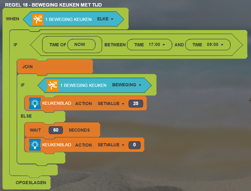

Sorry Richard, I might have misled you with my tip.
Try changing the between puzzle in your rule with the time-between puzzle. It will work, even if the first point of time is greater than the second. See attached example from a working rule that I use to control my TV.
You might have better luck using Time of: now, since what you are currently doing, is comparing now (date + time) with a general point of time. By using time-of puzzle you will be comparing two things of the same type (time and time)
Sorry for the bad explanation :-)
