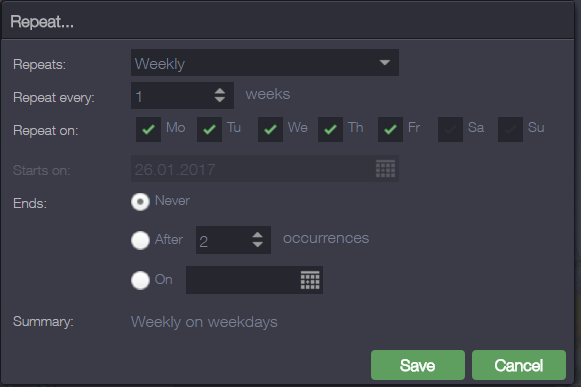

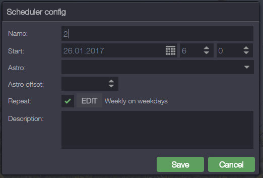

When i try to make a rule so a light turns on on weekdays between 6.00am to 6.30am it doesnt work.
i use the scheduler like the image attached.

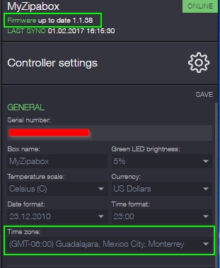

well i found out that the problem is the time.. for some reason the time is -2 hours. I checked it but both the time in settings in the web link and in the Zipatile are correct (+2 hours Athens). but instead of 6.00am the light opens at 8.00am..
Try to delete that scheduler and create a new one, I see there is a selection of "stop after 2 weeks", just in case, make sure you save and sync. If that doesn't work open a ticket on zipato support, scheduler seems correct other than the "stop" condition, is your box on a cluster?

What firmware are you running? On settings you can check if your controller is up to date and the fact that you chose the right Time Zone. If none of this works, open a ticket on zipato support (https://support.zipato.com).
