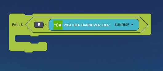

I think you should be doing test with the > puzzle and compare the times between the actual sunrise and the specified hour.

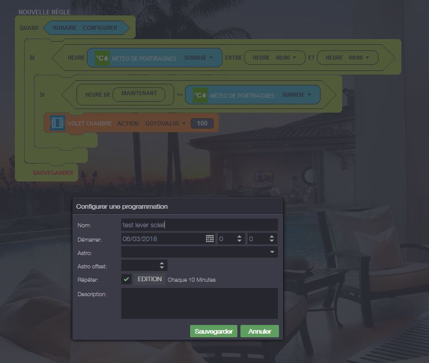

You could use variables as well. See attachment
