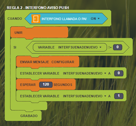

Hello all,
I tried programming the rule but still don't work:
5e08fa8ab1ad785ec2a8decbf5e59b68
Do you see something wrong?
Thanks for your help

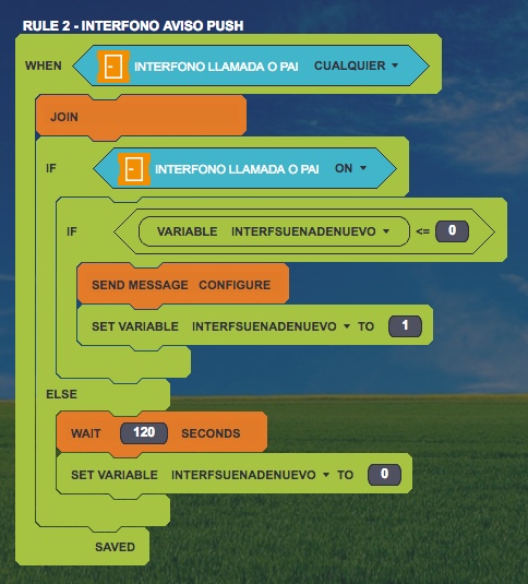

Pablo, try something like this.
Saludos!
Alberto, Jan, thanks. I have tried but messages still comming more than once. Looks like it ignores the wait or the variable value. See attached.

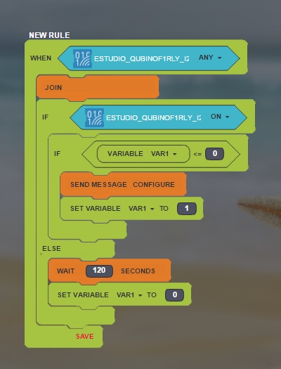

Try recreating a new rule from scratch using new variable
Attila, thanks but no luck here. I still think something on the rule creator is not working: variables or wait.
82a3e869806bf32531e58e02cd9c6ebc
I have also tried with virtual switch, but rule is not changing the switch status...
d0170ed89b782820435738b022653de7
