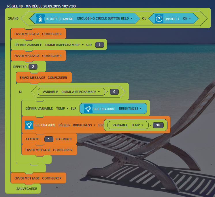

somebody can explain to me how to use the "repeat" bloc (find with the when and ifs blocs) ?
Seems not working after a lot of tries
Thaks,
Miron

Ok, so if I put "2", they will be done two times?
My tries with Push notification to debug show me that the rule stop at the repeat condition begenning!
Don't quite understand the rule but are you sure it is not something to do with the fact that the conditions within the repeat are not the same during the second pass?
/Marcus
I don't now, but the final goal is to reduce de value Off the Hue lamp while I stay push on the buton
If the on button on the trigger(remote) only sends one "trigger signal" as long as it is press and one more when you release and press the rule will only be triggered once even if you continue to press..... don't know how your remote works!
I'had try before doing this, and the remote only send one message at the beggening, (and an other at the end) and that's why I whant to use repeat bloc, but this bloc seems not working.
I have sames problem with repeat. Sometime stop before the end.
