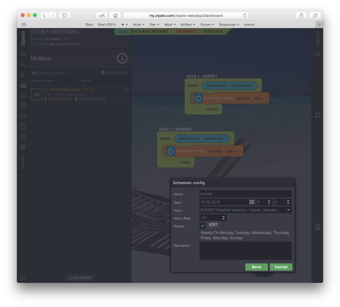

Currently I have only two rules, when the sun goes down, the outside lights (fasadbelysning) should be turned on. And when the comes up, they should be turned off. This doesn't work. I tried to change the scheduler to run at a specific time, didn't work either. I've used similar rules before to control the garden lights, but I wonder if something has changed? What am I doing wrong?

I have the same issue since a few months back. Sunset and sunrise rules does not work anymore. Any solution too this? I have made completely new rules but and not copied anything but it does not help...
I had the same issue. I solve it by creating a new weather station. My old one was not updated any more. That cause a lot of my rules to stop working. I think it should run even if not updated.
Rember to remove the old one and check all your scheduler to see that you have the right sunrise/sunset.
Yes, this can be an issue. Not updating weather station.
I have tried to remove everything, "cleaned" my zipato afterwards. Made all rules completely from scratch. I have even made a new weather station with new settings and new location. I removed all the rules, updated the zipato, and made new rules. No change - they still do not work. I can switch them on and off manually from the control panel in my.zipato.com but for some reason the rules do not work...
Can you post your rule?
