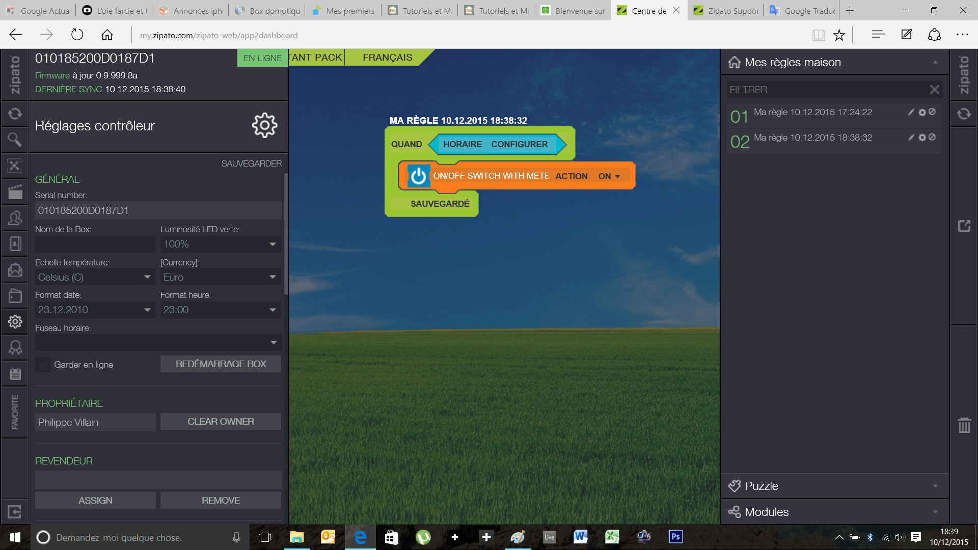

I am new to the used zipabox purchased.
The installation of the Zipabox is ok (0.9.999.8a view)

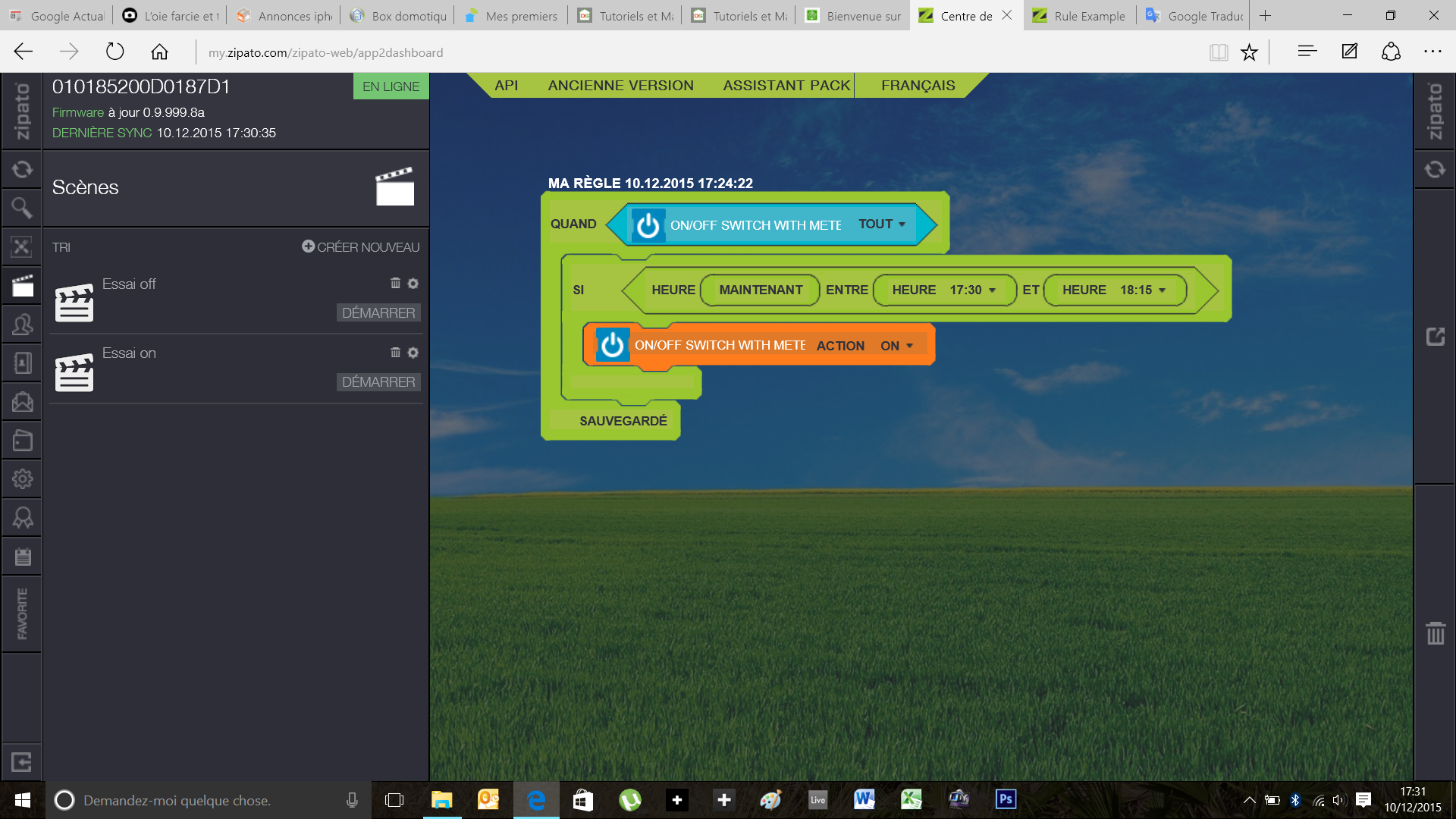

Association Fibaro wall plug ok: the module is present in the dashboard2 and controllable with the mouse (on / off) left side of the screen
Creating NOK rules: see attached 2 rules
I do not understand!
Can anyone help me?
For now I want to light a lamp between 18h and 23h ...
Similar to your second rule. use block When, add the scheduler for 18h. Repeat weekly for any day you wish to repeat.
block Action turn the light on,
block Wait 18000 seconds
block Action turn the light off

Ultimately problem GMT (1 hour difference): it now works. Great!

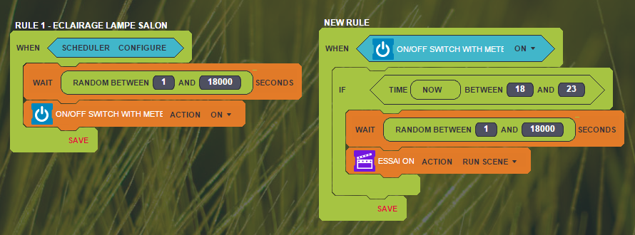

Hello Philippe,
you wanted the Rule to be executed at a random time so I have attached two Rules that turn the light On or execute a Scene at a random time between 18h and 23h To accomplish this I used wait puzzle and random between 1 and 18000 sec.
First Rule is triggered by a scheduler so you will probably use it if you want it to be executed daily or periodically at certain days of the week and a second one with a switch so it can be triggered at special events and not every day or every week. You can use a virtual and not a real switch in the When part of the Rule.
