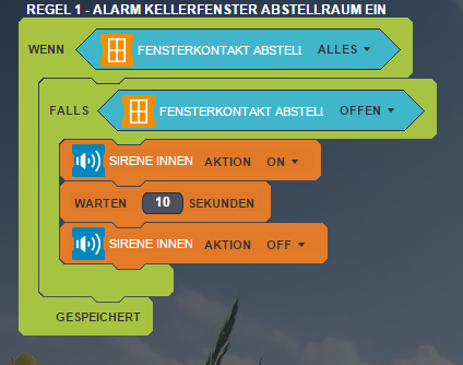

However, I also have troubles with the rule creator. I don´t know what I am doing wrong.
I have a very simple rule as you see attached, but it is not working. I have tried different variations but none of were working.
I just want that when the window sensors (Fibaro window sensor) state is open that the siren (Aeotec siren) howls.
The state of the window sensor is changing as it should. I can also activate the siren manually and of course I have saved and synced the rule. But within the rule it does not work.
Any suggestions?
Solved.
I just sync the box and not the rules.
