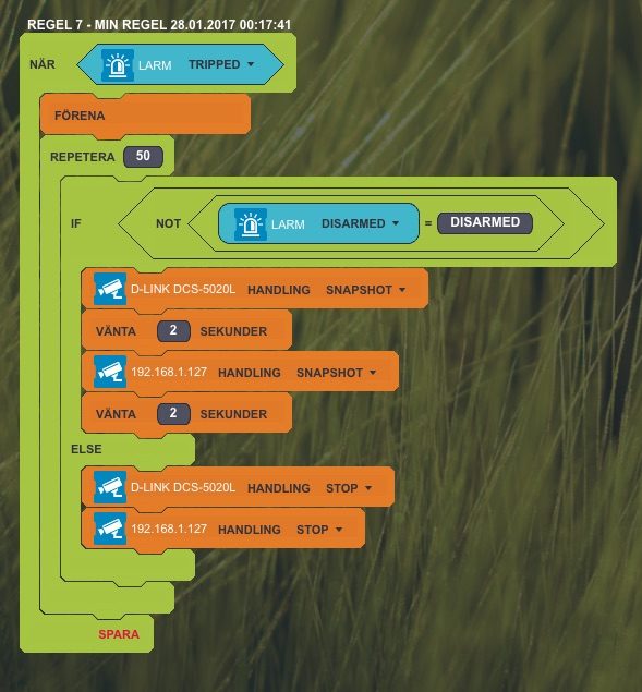

I want to have a rule like this:
When the alarm is Tripped
The camera take photoshots
each 2 second
For 50 times
If the alarm is disarmed it should stop taking picture
This rule take the picture but doesn´t stop.
The rule is here.
Is it possible to have the camera to take photoshots from that the alarm is tripped until it´s disarmed.
The rule is here.
Is it possible to have the camera to take photoshot´s from that the alarm is tripped untill it´s disarmed.

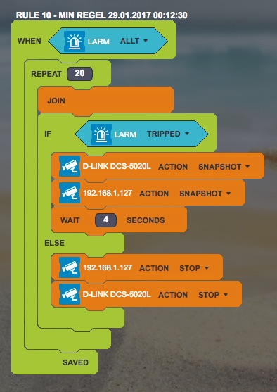

It take the picture, but it´s not stopping when i disarmed the alarm. I want the cameras too take photoshot when the alarm is tripped. So I think I need to repeat it many times. In this i only repeat it 20 times. I have test both with and without "Join"

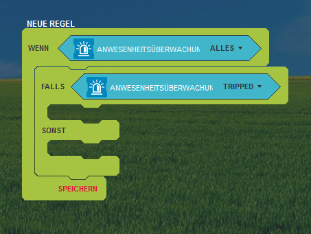

Rearrange the puzzles as the rule is not correct. After when put join. Anter join put if else. Inside the if put 20repeat.
Try refresh puzzle.
When your rule is started it does not know of any update of the alarm status, but it keeps all the values at the point the rule was started.
Try refresh puzzle.
