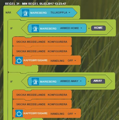

Some days ago my rule that should run when armhome/armaway stoped running.
When armhome/armaway the rule is not executed.
Anyone else having issues with alarm and rules?
Attached file is the beginning of the rule.
When disarm, the rule for disarming is executed and I think the rule for arm is executed aswell as the rule for disarm... because I get the push for arm at that time.
I have done some more testning and I think the issue is related to beta firmware (1.2.10). When loading official firmware (1.1.38) the rules started to execute again.
I also think the system is quicker and have less delay now...
Perhaps a bug in 1.2.10...
