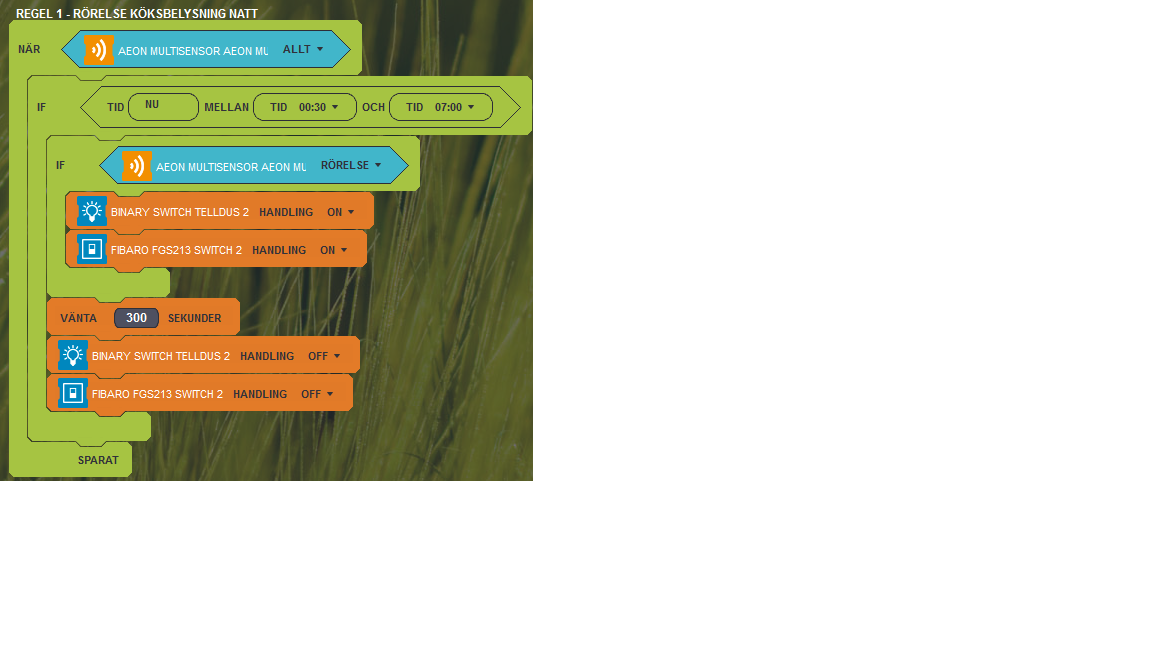

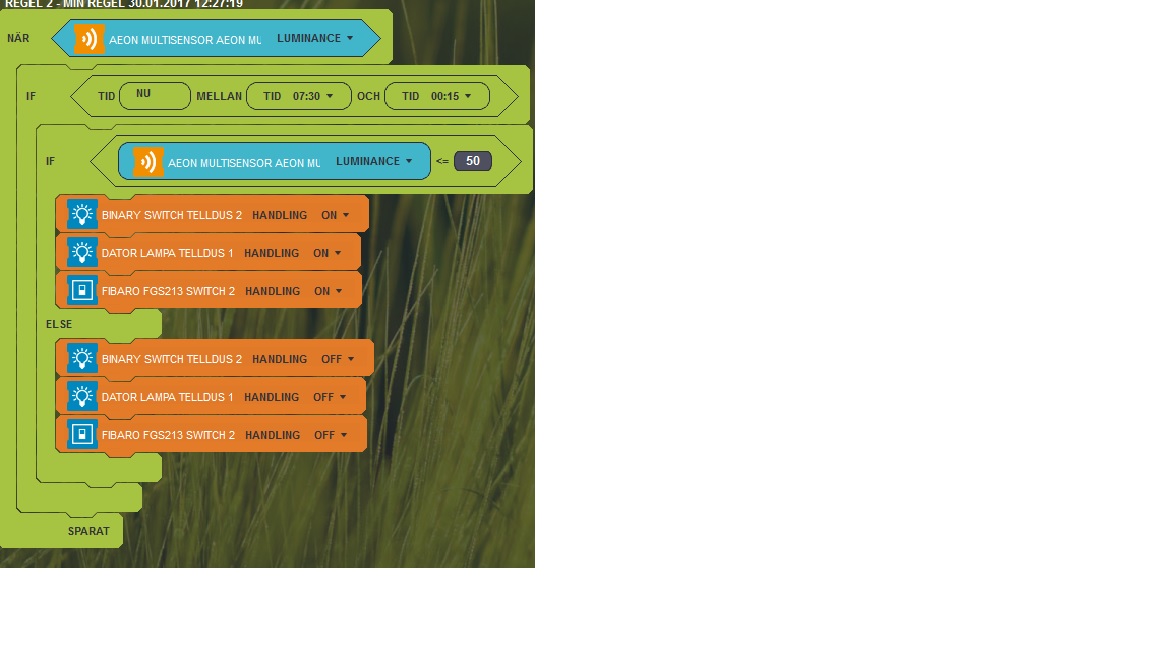

HelloI have a scene that manages the light with an aeon multisensor that lights between 07:30 and 00:15 if the light is below 50 lux. the problem is if you want the light on after 00:15 i turn on the light with the phone app the light turns off after 5 minutes. How can you keep the light going on until the next day to change the status of the light? ?

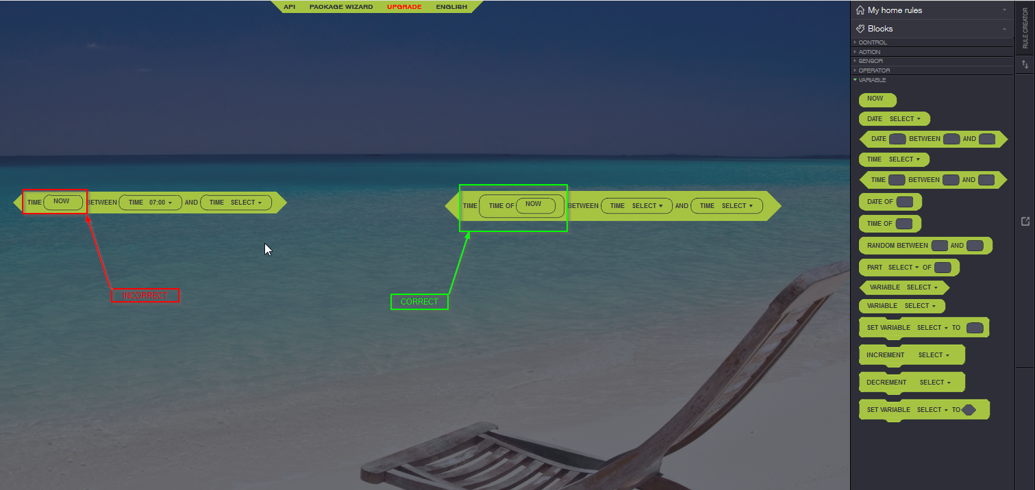

The first issue I see in your rules is the fact that you are not using the puzzle "TIME OF" before puzzle "NOW" see image attached.
Is your light close to the sensor? if it is close it is making the LUX meter to change and trigger the rule again, since your time evaluation is false then waits 5 minutes and turn it OFF.
