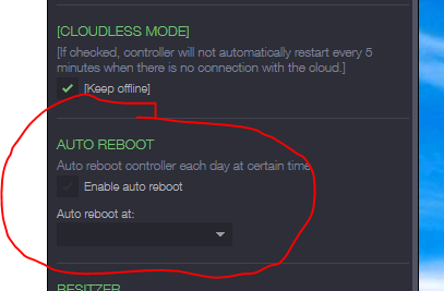

If you have the latest firmware please refer to Settings:
/f7901179181875f79fd138dbed65a92b
Which is this version? according my info the latest official is 1.3.61j and this option doesn't appear

I have firmware 1.3.65K and i dont have this option.
Is this hidden anyway?
Do we have to enable any features?
You need the beta 1.3.9X
