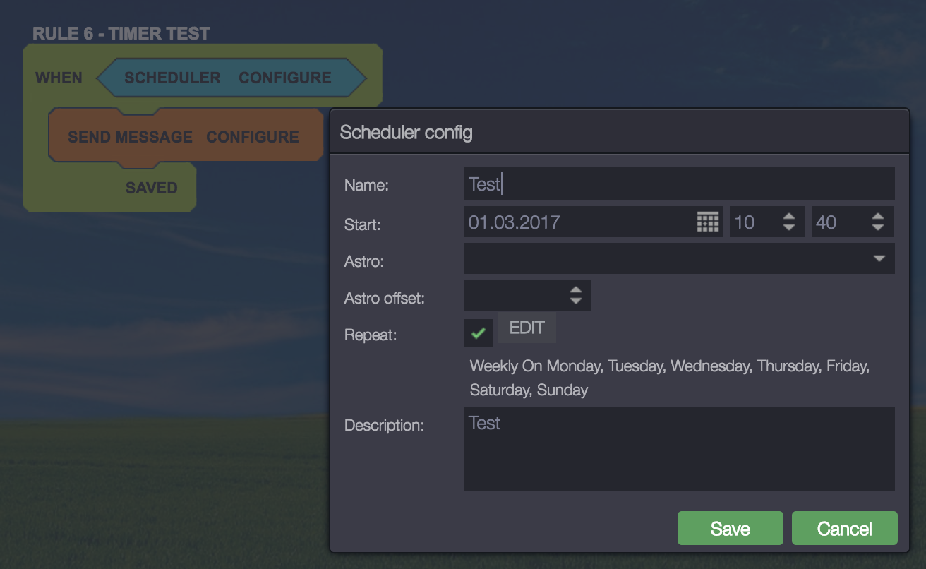

I have created several rules that works fine on my Zipabox, firmware 1.1.38.
However rules triggered by a scheduler do not work at all.
Is this a bug or is there a trick to this?
I have attached a simple rule, that should send a notification - nothing happens...

Hello Allan,
I've tried such a rule myself and it worked without and issues. You might recreate the rule and try it then. If this won't help, please open a support ticket which contains the S/N of your controller.

Hi Stefan,
I tried creating a new scheduler that repeats every 15 minutes and that works!
Then I removed the rule with the scheduler repeating every day and created a new one. This still does not work...
So I will monitor it today and then open a support ticket as there seems to be a problem.
Cheers, Allan
Hi Stefan
Just to follow up on this issue, it seems that weekly repeating events in a scheduler will come the day after, but not on the day that they are created (even though the events were in the future at the creation timer).
I have had a scheduler running with weekly repeating event and I have received notification on the two following days, but I never got it to fire on the same day that it was created...
Regards, Allan
