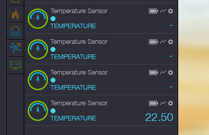

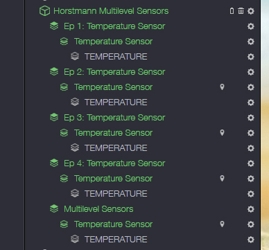

Yes I have managed to include it in the system. When I include it with the external temperature sensors attached (that is probably not the way it is designed to do), then I can see all of the attached sensors (as per Untitled-1.jpg), however temperature signal is not received from the external sensors, only from the one that is in the equipment (Untitled-1.jpg).

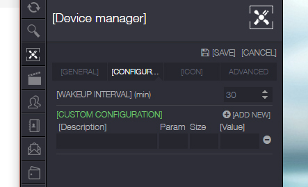

There is no configuration, as you can see on the attached screenshot. That could be the problem...
Well, it means to me that if the device supports various parameters, then this device does not have template (descriptors) written for it. So in general the system recognise as a device but not all functionalities are working. You will need to raise a ticket for support.zipato.com
