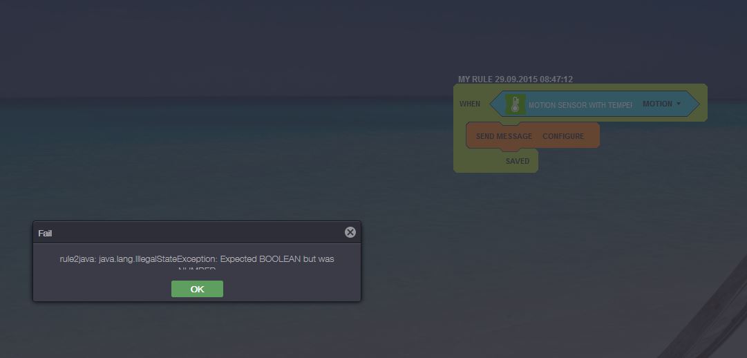

I've been playing around with a simple rule that sends a message based on an action. I've added myself as a contact and tried to create the attached rule. Every time I hit save, I get this message:
rule2java: java.lang.IllegalStateException: Expected BOOLEAN but was NUMBER
Anyone know what's causing this problem?

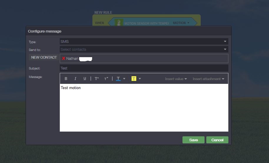

can you please show us the configure Tab from the send Message block?
regards Helle
regards Helle
Absolutely. I tried both email and SMS and get the same message with each. I wasn't able to find anywhere to enter my SMTP server settings, so I'm guessing it gets sent by the Zipato servers, but I can't find much documentation on the messaging aspect.

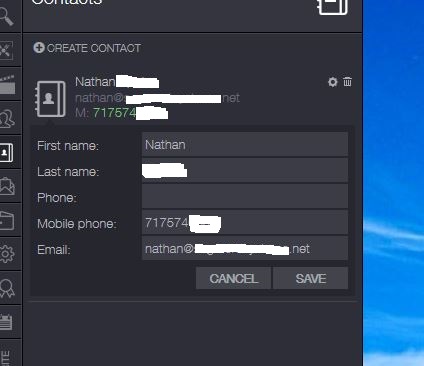

I found you have to be both a user and a contact for emails and sms to work. But SMS is a paid service now. Push should work fine. I have them all the time.

I have also seen the same error you mention and I think it is a bug in the rule generator.
I have found the following that seems to work:
a) Drag out the blue (SENSOR) puzzle piece back to the work surface
b) Re-apply the action (in your case "MOTION")
c) Drag the blue (SENSOR) puzzle piece back into the WHEN statement
d) Save the Rule
My assumption is that the SENSOR puzzle piece does not initialise correctly then incorrectly reports a NUMBER to the WHEN statement when it should be reporting a BOOLEAN.
As a faster workaround, I have found also that just resetting the action in the SENSOR piece (i.e. MOTION for you) will also work.
Best regards
/Marcus
d) Save the Rule
Best regards
/Marcus
Thanks Marcus. That work around allowed me to create the rule. I'm at work now, so I'll have to wait until my wife walks in the closet to see if it works. But the rule no longer shows as "Invalid" when I look under "My Home Rules".
