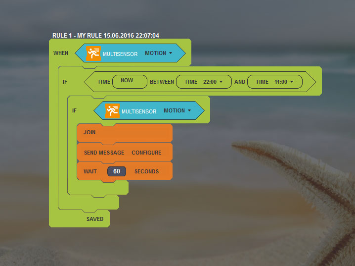

I created a rule which should send a message when motion is detected within a certain time frame (22:00-11:00), and I can see on the log that motion got detected but no message got sent. Tried push, email and sms, none worked. See attach of the rule, if there's anything wrong in that.
Also synced the rules with the device without any complaints.

Also, you should remove your JOIN and WAIT puzzle blocks. Because of that blocks, you don't receive your messages.
Remove those two blocks, save and synchronize your rules and your rule should work like you want.

Hmm, I thought Join is supposed to be used to avoid spam of multiple motion detections in a short sequence?
Anyway, loaded the beta and now it seems to work (even though it had join and wait). Btw, there are is no indication on the UI that there is a beta firmware. At the top left it says 1.0, and in the messages it still mentions the 0.9.9.9.8 firmware and nothing else. Is it supposed to be like that?
