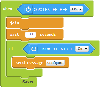

Sending an alert if light not off after some time
I'm trying to set up a rule to send me an email if someone forget to turn off a light.
So I got a switch on this light and I want to receive an email if the light is still ON after XX seconds (XX is the maximum amount of time I think this light should be turned OFF).
I don't want the light to turn off automatically, just receive the alert because some few times I need the light to be ON longer.
Here is the rule I made in attached file. The problem is that I receive an alerte even if the light is off before XX seconds.
Thanks for helping me !
Kinny

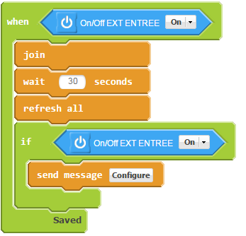

After the wait ...use the refresh all function.
Yes it works !!!
Thanks a lot.
I tried with the Refresh All function but not the combo with the join...
The correct rule attached to this comment.
Kinny
Yes it works !!!
Thanks a lot.
