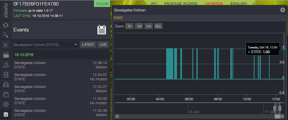

Appears I were to quick to conclude the fix. The sensor events are still 2 hours behind when looking at the event graphs. See the attached screenshot with time for sync and latest motion event.
