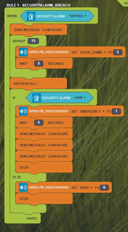

One piece of advice, if you expect to receive a warning from your siren during the entry/exit delay of the alarm, the built configuration will not suffice. I found that during these delays you cannot send a warning with either with built in config (entry/exit delays cannot be configured to make the siren chime for example) and neither with the rule creator since there is only Armed, Disarmed and Tripped Event, not "Entry Delay" and/or "Exit Delay". The way I went around this is not configuring an entry or exit delay, nor my siren. And trigger it using the following rule, hope this helps.
