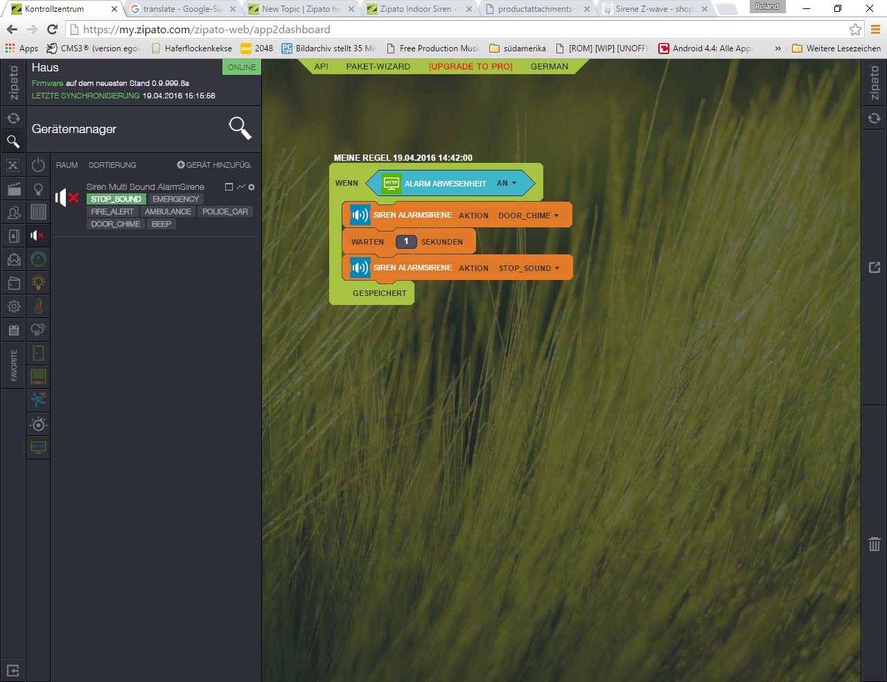

Hi Milan, 2 days ago MI zipato sire ln went off in alarm more for no reason as both me and my partners were home, once in the daytime and once just after I went asleep...I'm pleased it did not wake up my sleeping child.
Do you think that this fix can also help for this problem? I have unplugged the siren for now as I had no time to look into fixing it.
thank you , it works perfectly
