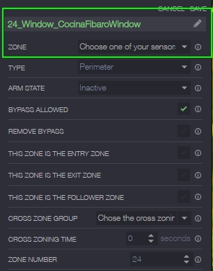

The same thing has happened to me, you have to sync after you save and then refresh the window so they appear again. I don't have a keyfob but the same happened to me with my yale lock.
With the server outages some funny behavior may be expected, right now my zones are not showing the configured sensor (none of them).
