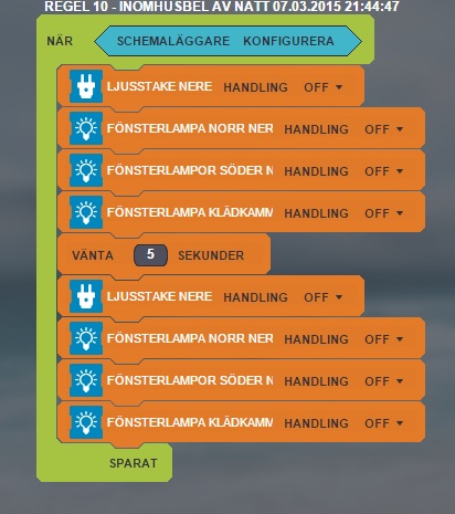

Would this work?
Files: rule.jpg
Try a little war between each command. Just for testing. If it works fine. Try to remove. Test again. I made a experience, that sending a lot of commands each after the other some get lost.
Ok thx, I will try adding one sec between every two commands and see if that helps.
