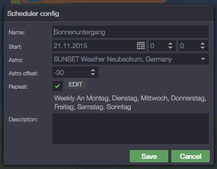

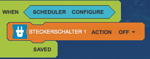

This rule turn a light off at sunset.
I think you have to start the scheduler in future

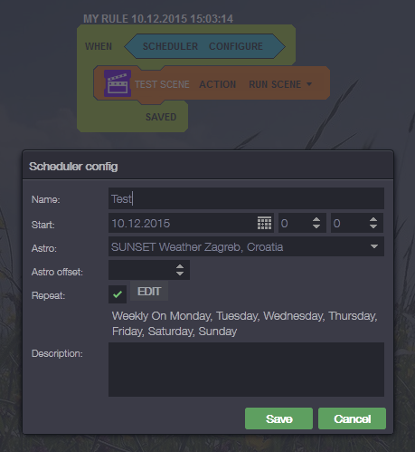

Hello Henrik,
below is the Rule that runs a Scene at sunset and as Attila said, you need to join a Virtual weather station to use sunset/sunrise in Scheduler puzzle.
