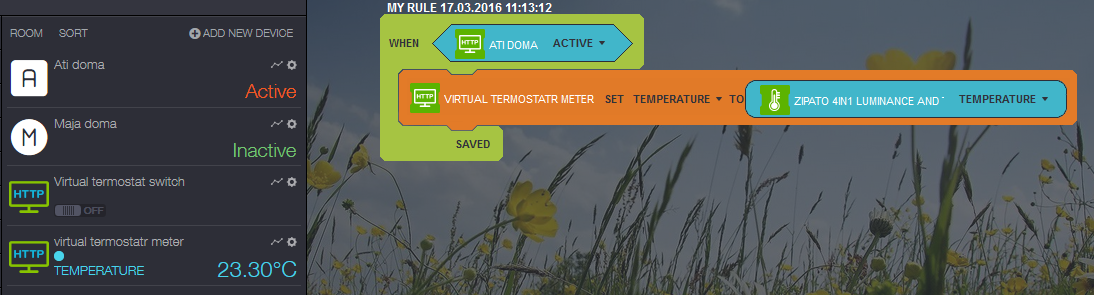

I have the solution. Philip, the solution requires the input measure change not the output. So here is the deal:
You have 2 virtual thermostats, that is fine. For the bedroom thermostat you do not change anything. For the living room thermostat you do the following:
1. create a virtual meter and set is as thermometer input for the living room thermostat. now you create 2 rules, one for the daytime and one for the evening. The daytime rule will be scheduled at lets say 8am in the morning and it will set the virtual thermometer to the temperature measured by the living room. The second rule will be schedule at bedtime start time and will set the virtual thermometer as the bedroom temperature. I have attached the rule that you need. Instead of the Ati doma sensor you will insert a scheduler that will repeat every day. As you can see the virtual thermometer is 23,3 degrees which was set by the rule immediately once the Ati doma sensor become active (is did not have any values before executing the rule).
Simple:)

Actually I was thinking, you will need to make either more rules as you need the temperature to be synced on a regular basis (like once every hour) or put a repeat, refresh and wait puzzle so it will refresh the temperature according to the new measurement.
