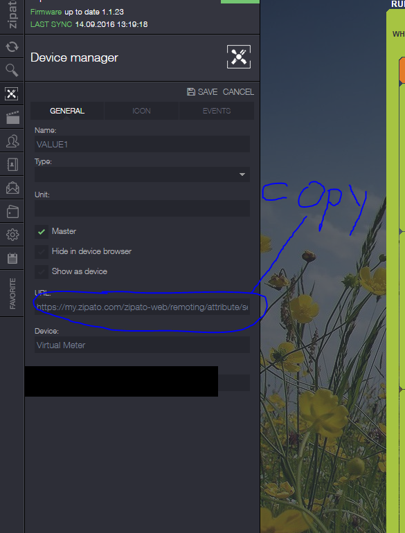

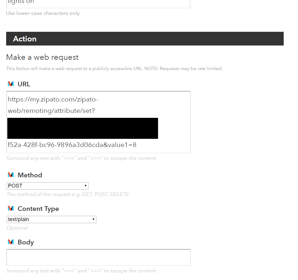

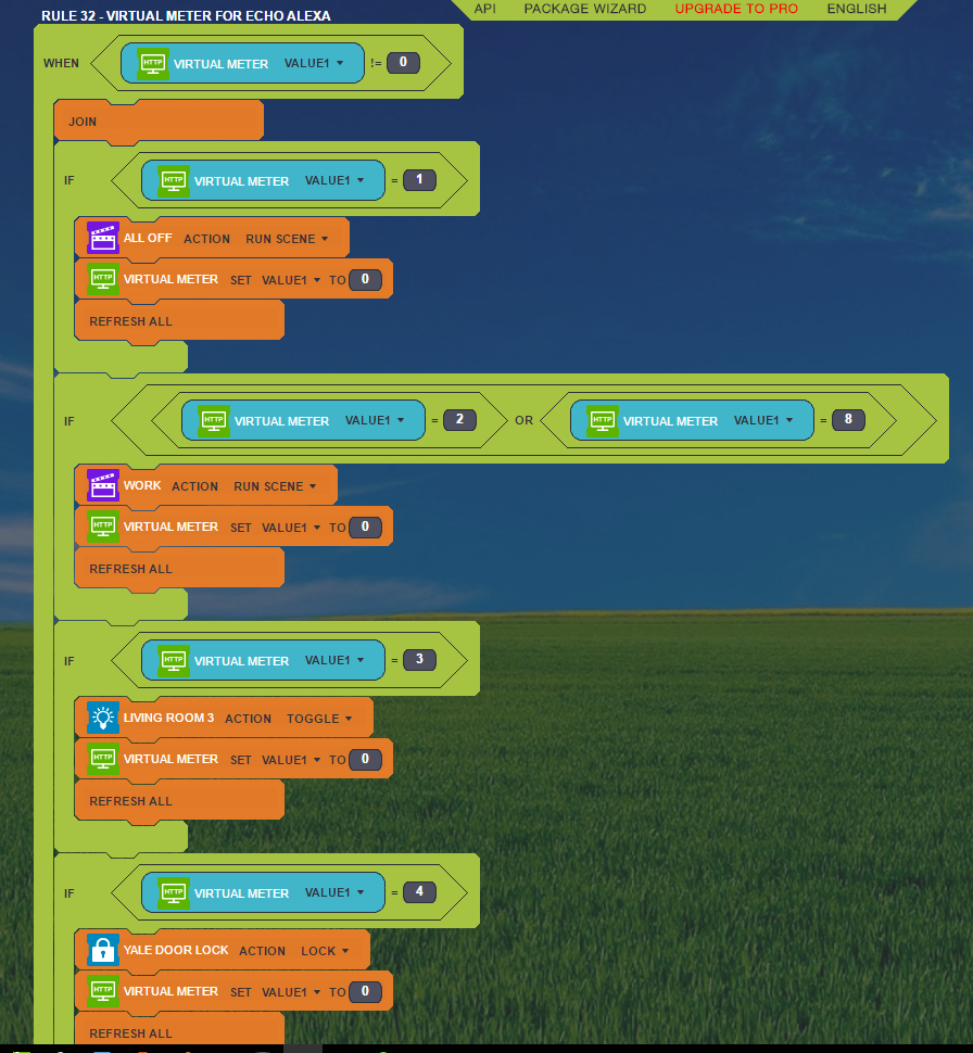

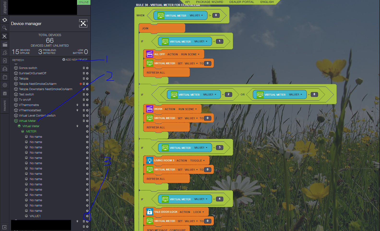

You need the Maker channel to do this and a Virtual meter in Zipato. See attached pics for an old Alexa command. Obviously you would use the Skybell as the IF trigger not Alexa.
Well I was planning on using a virtual meter, to make it ring through a songs system, but the Maker webhooks doesn't seem to respond. I have tested the url, and it works, but the webrequest through Maker can be delayed up to an hour. Any other tips?
really? I was using webhooks (formerly maker channel) for the Doorbird notification request and it worked fine. Both get and post.
Are you using webhooks for the "That" http post of the virtual meter value into Zipato, or the get call from the skybell.(not sure if you the api or http call for this).
