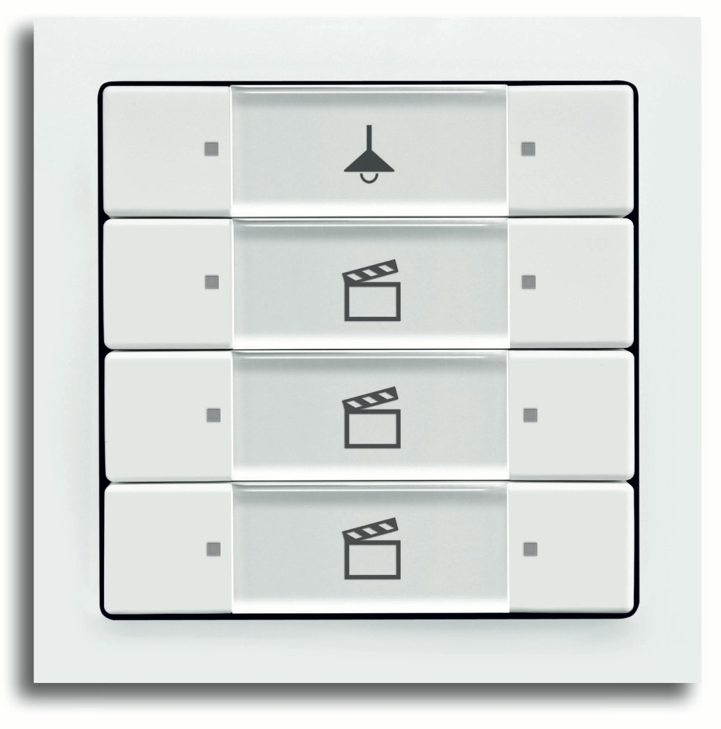

I am considering really build my own button with a Philips Hue dimmer switch. But what I really want is to have a rotary dimmer. With wireless capability, something like this that I found: https://www.youtube.com/watch?v=ib7Zqf6-2EQ
b6e0779b262a22f7a0011485c47b8ff1
http://www.enerbee.fr/dimmer-module/
3cf26b7afe2a3887f3d2dd0b7b4c1673
http://www.busch-jaeger-katalog.de/files/files_ONLINE/Systemhandbuch_ZigBee_BJE-25-11-2015_EN.pdf
