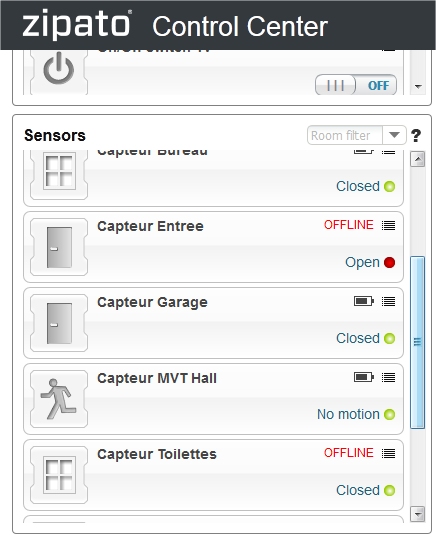

            Hi Zipato Team & Zip' users,
I have 2 devices SM103 still Offline after battery replacement.
So far when I changed battery for those 2 devices every 2 months, they turned back from offline to online.
But today I change my battery 2 times for each in case of faulty battery > same problem !!
Any ideas,
Details to Zip' Support : ZIPACHRIS
Capteur Entree / Door sensor / Hall
Everspring SM103
Device UUID = 149b2750-8658-4acd-bf1b-6ec7e4717bb1
endpoint UUID = 09548176-6ce4-44ee-9842-bf7f7552c7cc
Capteur Toilettes / Window sensor / Hall
Everspring SM103 Toilettes
Device UUID = 6ec0a100-bada-450c-8b8f-e2fecb353fd9
endpoint UUID = 6f78b72e-c88d-453c-bc19-179d6c4e844e
            151118_sm103_en...
Additional information : I did not try to remove / add the offline devices so far it had not been necessary when replacing empty batteries.
Try to do a apply device descriptors. Go to the actual item in device manager (highest level of item), go to settings, scroll down. There is a apply descriptors. You probably will need to wake up the sensor as well.
Hopefuly it helps.
Hopefuly it helps.
Hi Attila,
applying descriptors was not enough : I had to remove / add my 2 devices
Now they work fine :> but I had to remove / add them in all my rules that is a Pain :/
Hopefully won't have to deal with this regularly.
Thanks for your help.
