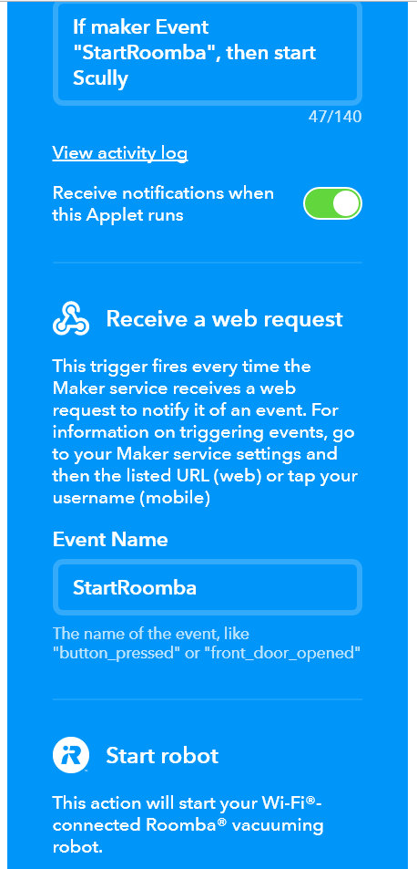

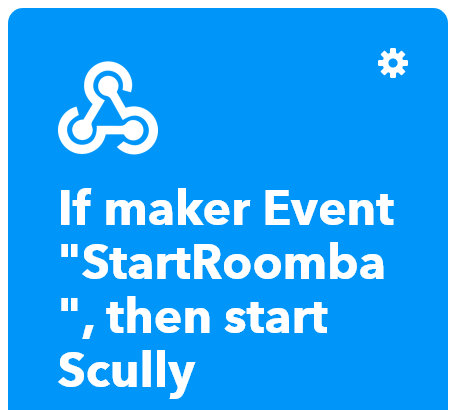

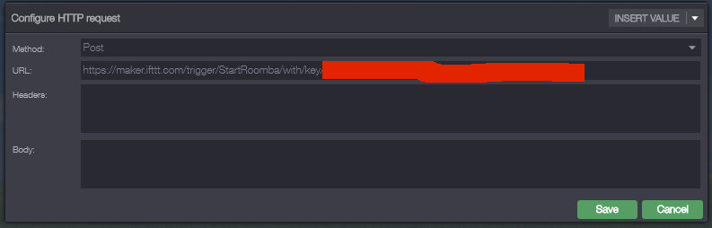

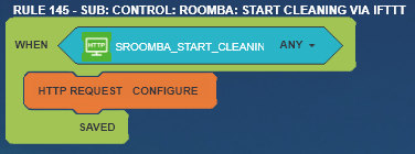

The IFTTT integration works. I was able to set the Roomba cleaning by triggering a switch in the Zipabox, then stop it and send it back to base. Now to see whether it works reliably.

Could you tell me how can we make it work ?
