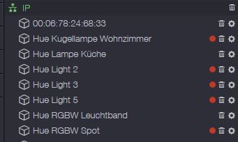

Since some days several hue Lights are offline. Others are online and work.
In the hue app, all lights work properly.
So, what can i do to make them online again ... ?!
Thank you in advance
Here is a screenshot

I had the same issue after some internet problems at home. I rebooted both controllers and then started to run scenes from Zipabox and then the red dot dissapeared and I was able to control them afterwards.
My Lamps appeared also again after reboot and some time.
