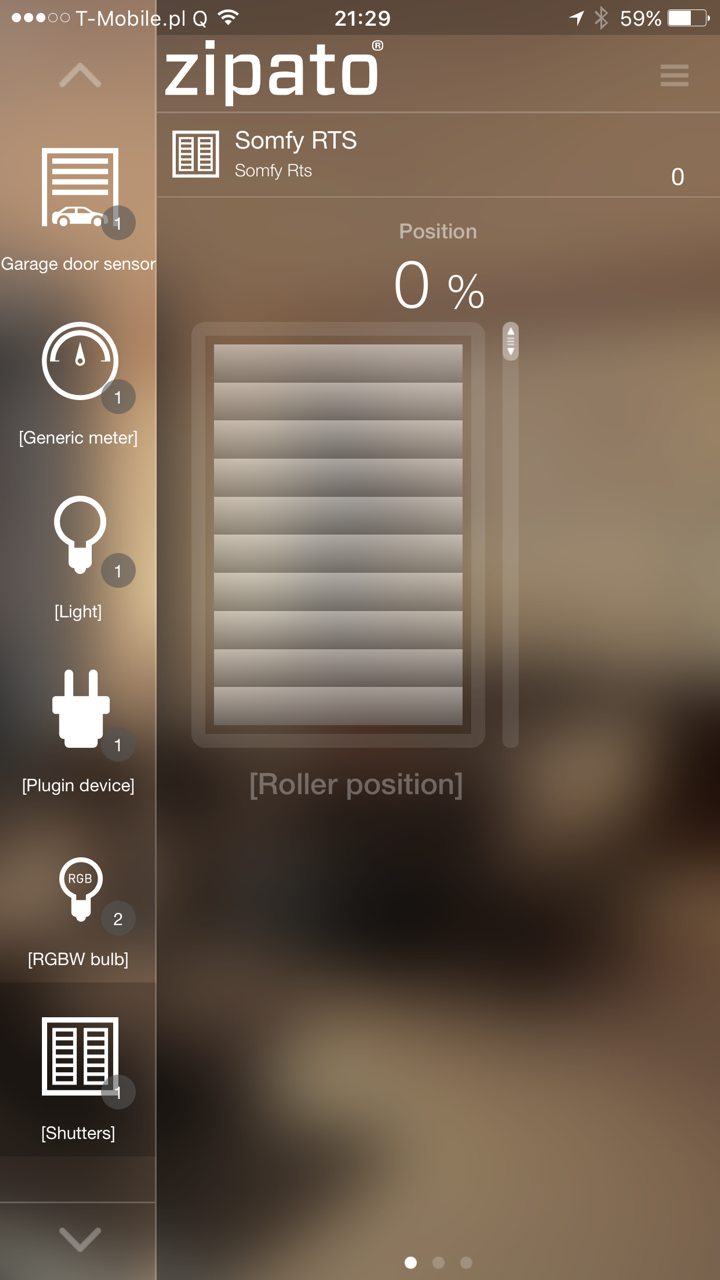

Hello, I would like to configure opening the garage door working on the Somfy controller. At this moment Ziapto sees and opens the door but it basis of blinds [Roller Shutter] instead switch on/off, Zipato shows percentage position of opening of the gate. How to change it to on/off?

You might try to change the device's settings from web app, going to shutter's endpoint type to Generic On/Off but I don't know if it will respond to this commands, sync before you test it.
or just create a virtual switch, then a rule that When on, set garage roller to 100%. etc etc. And "hide" the Somfy garage door device
