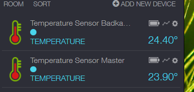

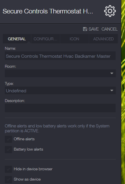

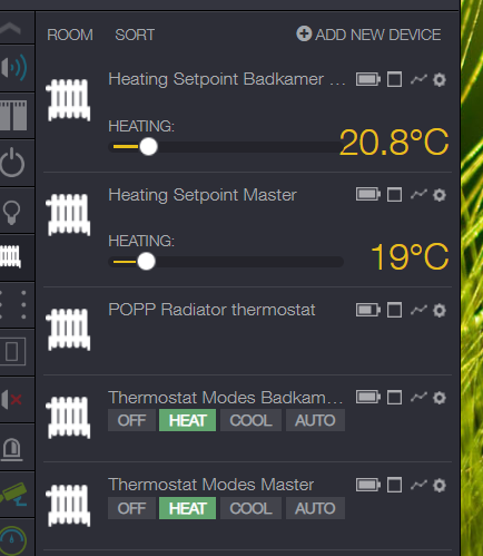

I have purchased 4 SRT321 thermostats and 3 FIBARO FGS-223 to create zone heating in our house (floor heating). I am having trouble to figure out how to have the SRT321 control the FIBARO FGS-223 to open or close the floor heating valve at a certain setpoint. The SRT321 do not show as thermostat but only as temperature sensor and radiator (see attached files). If it were to show up as thermostat it would be easy to control the FIBARO FGS-223 as the zipatile build-in thermostat swicthes the relay 1 and 2 on/off switch. I can't change the type, which is currently undefined, of the SRT321 either.

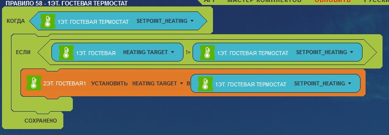

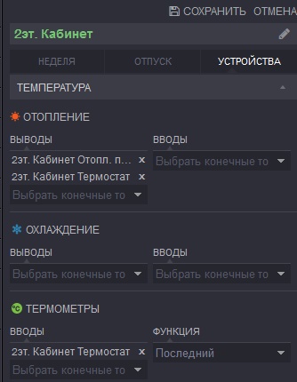

I use a virtual thermostat. On the output of heating - srt and fibaro, on the input of temperature - srt. Plus a separate rule for changing the setting of the virtual thermostat with srt.
The rule for changing the setpoint of the virtual thermostat with srt.

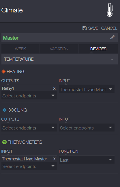

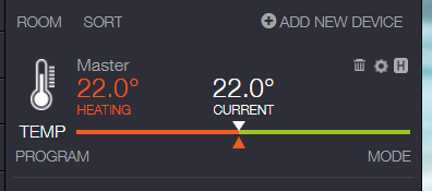

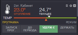

Hi Babur,
Thank you for your input! I have tried to use a virtual thermostat (however, it should not be needed as the SRT321 should be recognized as such) but that isn't working either. As you can see in the attachments not the current temperature, nor the setpoint is displayed correctly by the virtual thermostat.

Hi Babur,

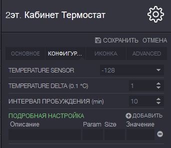

Добрый день. Для того, чтобы значение уставки SRT должны быть передано на виртуальный термостат, я использую правило, указанное выше. Для того, чтобы значение уставки виртуального термостата, чтобы быть переданы на СТО, необходимо поместить SRT в выходной секции нагрева виртуального термостата. И не забывайте о синхронизации после каждого изменения. В настройках SRT, необходимо указать время пробуждения 10 минут, так как, если виртуальный термостат не получает значение температуры в течение 30 минут, он показывает температура по умолчанию составляет 22 градусов.
