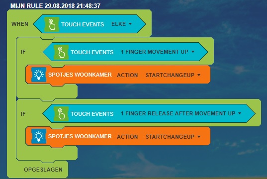

is there a way to make STARTCHANGEUP go slower?
it's going too fast for my dimmer and LED spots, the time I release the finger the spots are on maximum value...
anyone an idea how to set this up??
The second IF is wrong. That should be STOPCHANGE no? In your picture it never stops
yes you are right it's working better now little bit too fast still
