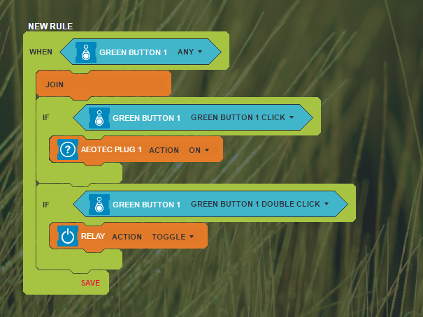

not sure exactly what you mean here, for your example you would use a when button any trigger, then 3 different ifs in the rule, if sensor block button pressed etc, another if block sensor when button held etc etc etc like I have attached. How do you mean?
oh you can scroll down on the main screen too, in chrome browser hold down middle mouse button.
Adrian,
Just tested. you're right; the middle panel in the Rule Builder can scroll.

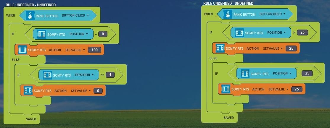

Adrian,
That is correct. As many IFs as I need, where the testing of the IFs in the list stops after the first TRUE, functionalitywise identical to the nested IF/ELSE statements in your sample "Using a Panic..." rule above, but "visually" and "structually" without the ELSEs and without the empty "end if" except for the last.
As described in my request, this is not programmically required as the same result can be created exactly as you describe. It would, however, make the rules simpler and visually easier to comprehend (and see on the screen).
