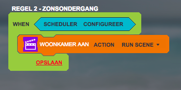

I am trying to setup a sunset rule based on a virtual astro switch. I want to switch my lights on at an half an hour before sunset. I never managed to get this working, I changed the astro offset time many times, but it still is not working.
Can someone help me out?
The woonkamer aan (livingroom lights on) scene is:

However I can see that you have hours = 3. Create a new scheduler and after adding a name, just insert the sunset and offset + repeat. Dont add hours or minutes. If no good, open a ticket.

Follow Attila's advice, you cannot configure a scheduler to run at a certain time and also with astro functions.
