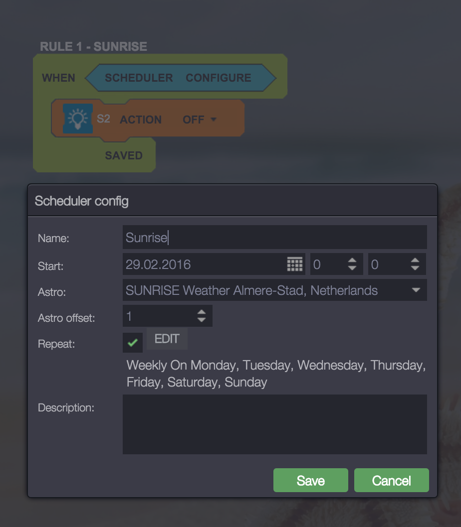

I have read all around this community and searched about the Sunset and sunrise rules.
I recreated them 3-4 times. but still No success at all!! they simply DO NOT WORK!
I am getting frustrated from this and is one of the most serious features I miss from my previous setup (HC2)

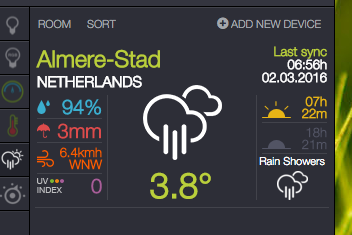

I use Virtual weather station.
Here is a screenshot of my rule

try to deactivate the rule --> than sync the Box
Actives the rule ---> sync the Box
If that it not working, delete the Rules, sync the Box. Restart the box, and create the Rules again.

Vassilis, try Amsterdam. Maybe there is no data for Almere.
Resolved by syncing with the proper button the rules :)
