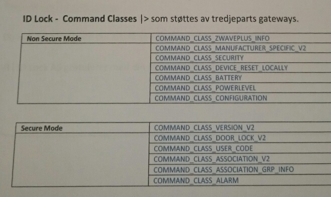

enclosed are the supported command classes
Their goal is to release the new firmware sometime this year, but they emphasize that they are uncertain about this :(

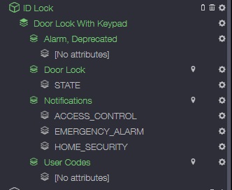

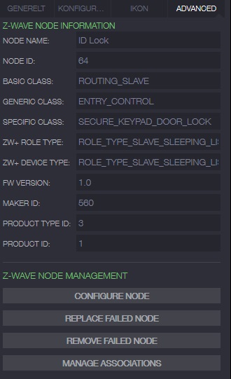

Never give up :-) Today i position my Zipabox 1,5 meters from my ID Lock and manage to include it with functions. Nice!
