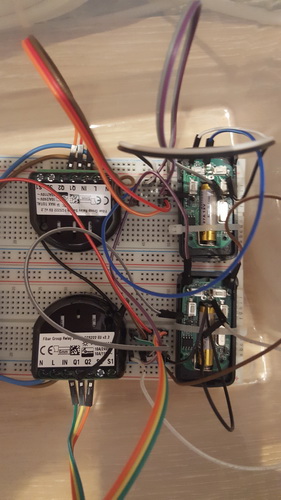

I implemented the following workaround:
I cloned the remotes to new remotes. I opened the new remotes and made connections(solder) from the buttons to the dry contacts of Fibaro double switches. The switches can be configured that they close only for .5 secs simulating the button-hit on the remote.
I need 1 double switch for each drive (up/down). I used breadboards for flexibility (see photo). The photo shows the device for 2 shutter drives. It can be placed anywhere. Together with door sensors now I can control my shutters/shades etc.
