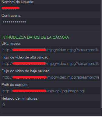

Hi, I just have configured a couple of Axis IP cameras and there are still some bugs. But stream, low quality and high quality videos can be seen through my Zipatile, live.
The key was to match the proper URLs for each.

Pablo,
Could you kindly post the contents of the camera-related fields from the Control Center so I can compare and try to figure out what I have wrong for my Axis cameras?
