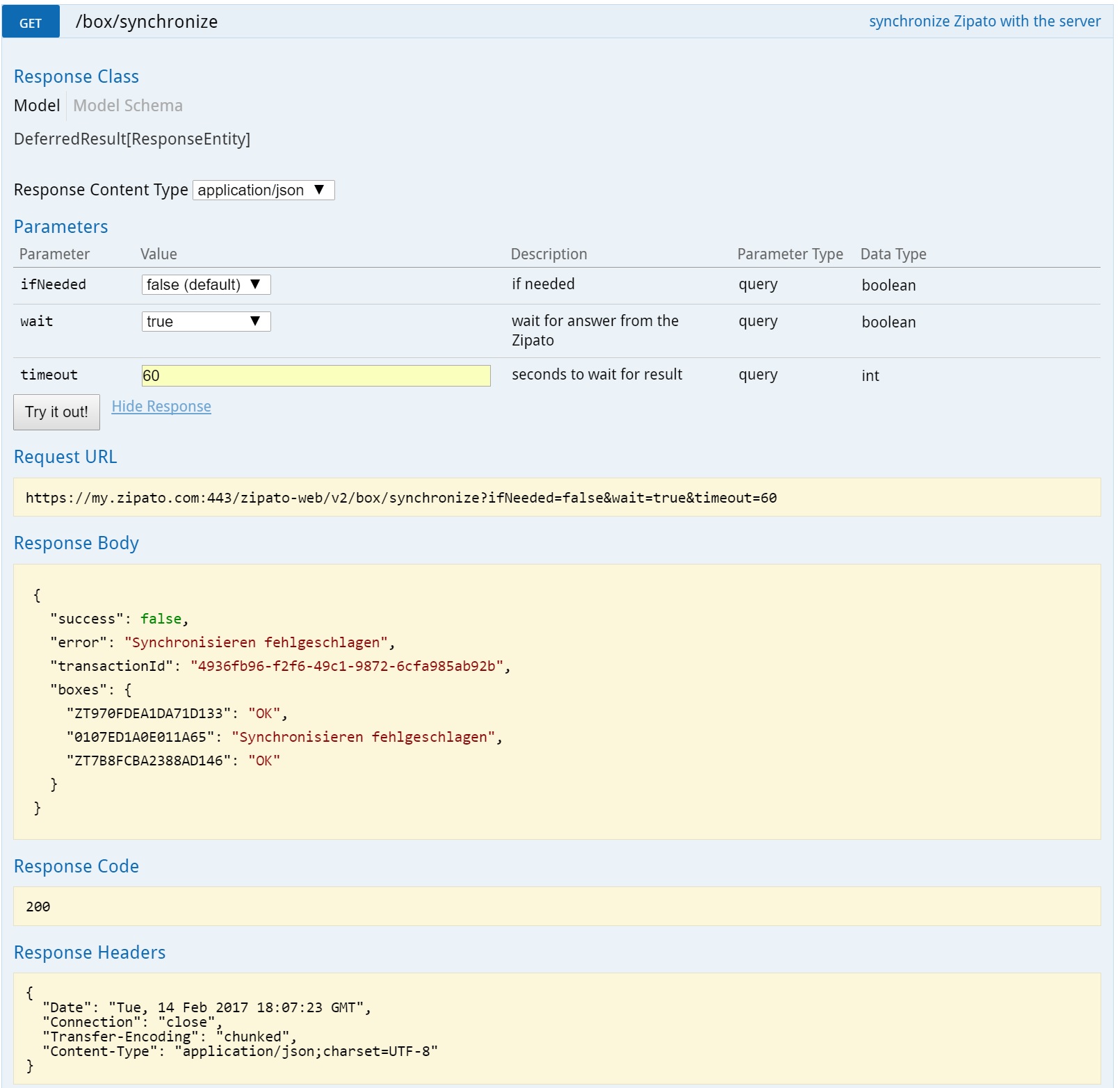

I just tried /box/synchronizeRules and it appeared to work first time with a 60-second timeout.

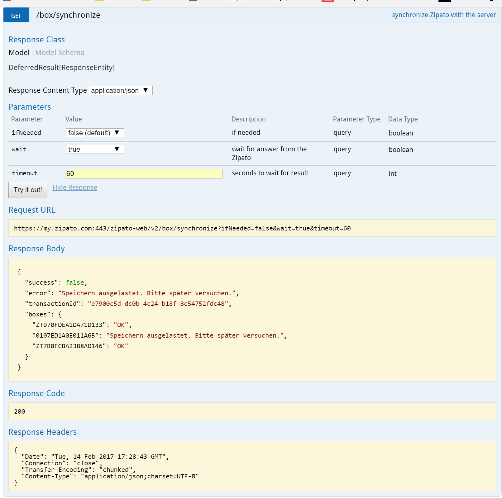

I've tried SynchronizeRules twice and it's worked both times. Synchronize has timed out once and given me "storage is busy" several times. But the nice thing is that it tells you if you need to synch or not (it seems that when you modify devices the changes get synched right away, but I was never sure about that).
When you change rules only it's enough to run synchronizeRules without syncing box. It's very fast comparing to syncing devices. I'm glad it worked for you as well :)
And "storage busy" is probably error message from box telling you that writing new data to storage hasn't finished, so you can't start new synchronization. As it's very little communicative it actually makes sense.

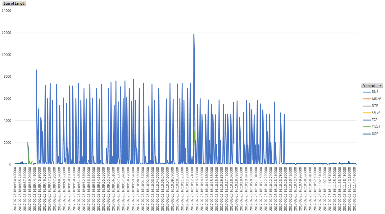

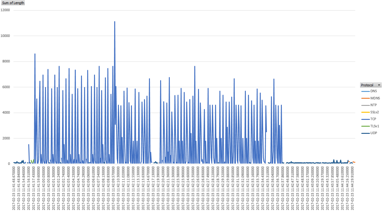

I have done measurements on a succesful sync.
It only took 41 seconds to transfer the data and then it waits.
Perhaps default settings is 30seconds when using GUI so in my case it is not enough.
I used the API in the test and had the timeout set to 300sec
Here is another packet capture when I sync from the GUI and get a "failed sync.."
Exact 41sec also, and the sync times out after about 120sec as failed.
