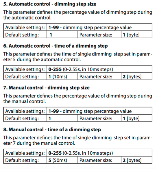

Very strange that this is so hard with Z-wav. And that you don't can make rules that dim the lights between a certain time to create a smooth dimming in a home cinema setup. You can setup on Fibaro dimmers, start change up or down but it is not beautiful with very obvious steps and not possible to set ups the time.
It is very complex with Z-wave to control the time you want lights to go from 0-100% or the opposite. You can set a value in the dimmer settings but that is often very short. 0 to 2,5 second.
Maybe you want half a minute to dim when movie time is ahed. And you want 1024 instead of 99 steps, not visible steps, like now.
And yes I know how to make a rule with time between steps. Is this even possible with z-wave? Maybe ask Fibaro about firmware update?
