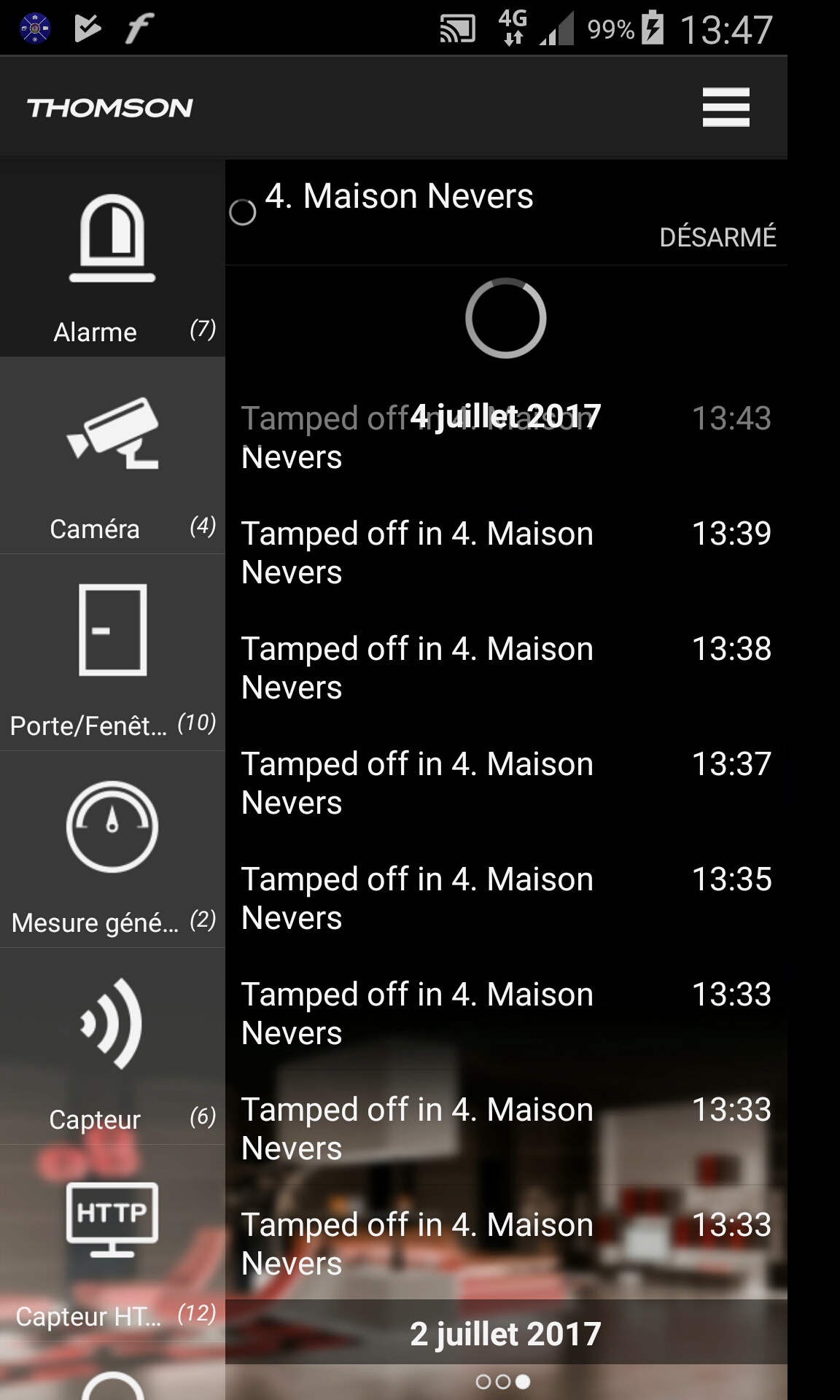

But my problem is different: this is a repetitive information appearing in the history of the partition (log in the dashboard) in the form "Tamped off in partition xxxx". This event doesn't trigger the alarm.

J join a screenshot.
As you can see no problem appear on the 03 july.
But yesterday the information appear very often between 13;33 and 13:49.
Many thanks for your help

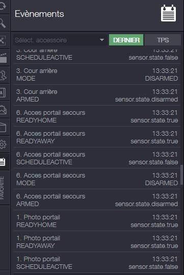

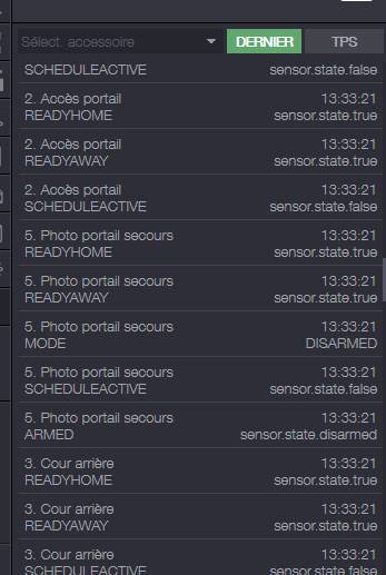

I send you two screenshot of events on 4 july.
Sorry files are bad. I will send new files.
Hi Adrian
New files.

Sorry I never got back to you Andre. I must have missed the updates. Jorge, what I have found is that the tamper can be from any sensor included in your alarm partition. I have had a Aeotec Motion sensor set it off due to the vibration/tamper alarm in the sensor being activated. And sensor was never touched. What was happeneing is the vibration from the AC unit nearby was setting off the vibration sensor. And you can not disable this via the Aeotec parameters.
So instead we had to disable the Tamper alarm section in the alarm panel. Yes this sucks, as it would be nice if you could just disable the tamper for that 1 partition, but unfortunately you have to do it for all partitions. And to do this you will need to go to your alarm menu (online control center, device browser, alarm) Here you will find your alarm partitions. In the very top menu here is the menu options Room, Sort, Configure, and Add new device. Select Configure, and disable tamper.
This should resolve your issue
