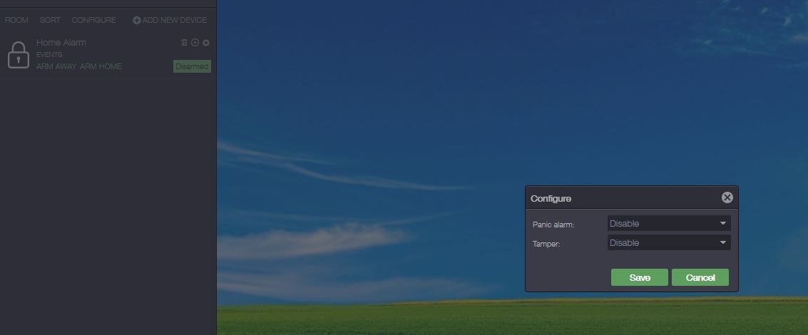

You can disarm the tamper function, i did that - no more fake alarms.
How will i do that ? i cant find how to disarm the tamper function for Fibaro door sensor.
I had to do it in the alarm configuration. I think it disables tamper on all the sensors, not just a specific sensor.
Thanks. it works , but still it is not the best way beacuse all sensors now dont have tampering function.
