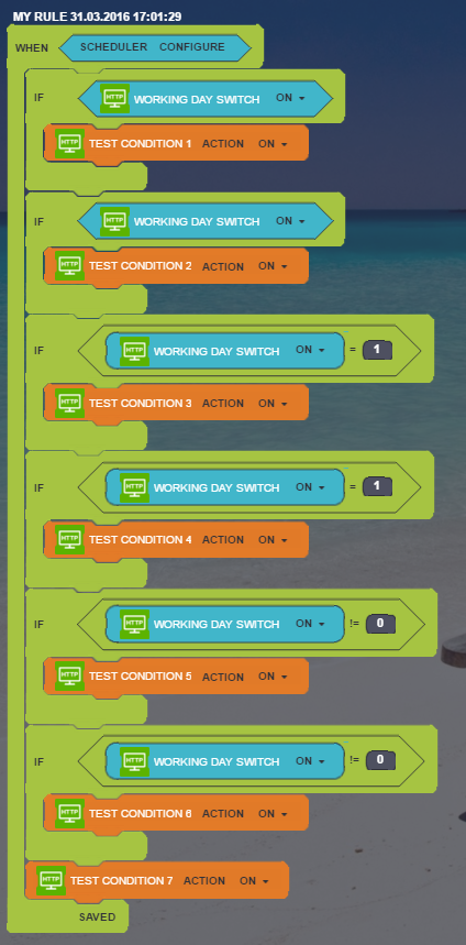

I've noticed that simple boolean conditions (testing the state of virtual switches) in my rules sometimes fail to evaluate correctly. So I decided to put together a test to try to get to the bottom of the problem. I have a virtual switch called "working day", which, during the test, has always been set to "on" (it's set at 1 minute past midnight every working day). I created a rule which tests this switch state 6 times, in 3 pairs. In each pair, I first test using an actuator piece, and then using a control piece, in case there's a difference. I the first test pair I use a sensor piece. In the next a meter piece whose value I compare to 1. And in the last test I use a meter piece and test if it's not 0. For each I created a test switch. I added a final test switch at the end to make sure that the rule was running.
Result: none of the conditions evaluated correctly. Only the final test switch, number 7, was tripped.
How is this possible? Is there some other way of testing a virtual switch state? Does it just fail randomly?

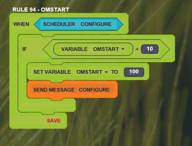

To understand what happens in the Zipabox you must create a rule that sends a message every time the box restarts spontaneously. It happens more often than you can imagine. And every time the hole memory are cleared. What you se in the device browser has very little to do with what the box remember of the status from before the restart.
Just create a simple rule as this and you get a message every time the box restarts.
How do you configure the scheduler?
Minutly.
Normaly the routine should have nothing to do so it doesn't matter that it runs frequently.

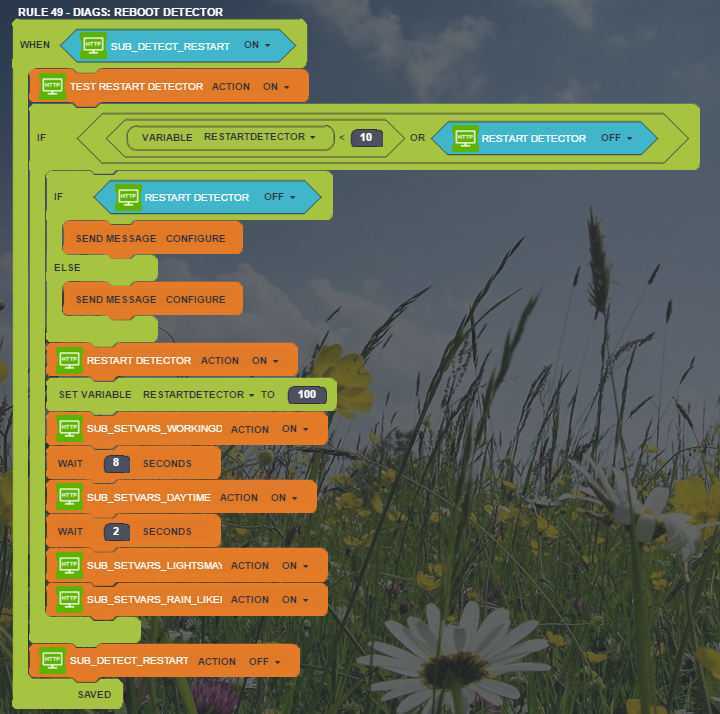

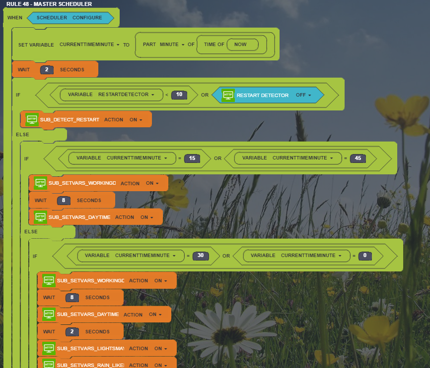

This is my "Reboot detector", copied essentially from Henry's idea. The idea is to have the variable set to a value that it will never have when the memory of the box is cleared. I also added a switch which I initialise to "on". My theory is that, if the box disconnects briefly, variable values get copied back after the box reconnects, but switches remain reset to "off". That's even after the latest firmware update, I think (remains to be confirmed!). So this rule would detect both reboots and disconnects which leave your switch states messed up. It sends a message for diagnostic purposes and then calls a series of "subroutines" to restore the states of the variables and switches so that the other rules can work correctly.
I imagine Henry and I do something similar - I have a set of values that I calculate from basic information. For example, is today a working day? Is is autumn, winter, spring or summer? Is it cloudy? Is it likely to rain? Etc. etc. For some of these I originally ran a rule just once a day to calculate them (and used only switches). That fell foul of the box disconnecting - the switch states kept getting wiped, and my rules kept failing. So now I run the rules more often. And if I detect that the box has rebooted or disconnected, I run them straight away to restore these basic values. This last idea, again, is Henry's.
So now onto "subroutines". The reboot detector is itself an example of one. Instead of running at a particular time, it runs when a switch is activated. I create a switch for each subroutine, say, Sub_Run_Rule_XYZ, and set it to "on" when I want to invoke the subroutine. At the end of the subroutine, I set it to "off" (this is important, otherwise the subroutine will never run again!).
You can see that the reboot detector runs a series of other subroutines (all the switches set to "on" whose name starts with "Sub_".
This system may not be 100% reliable but it's working pretty well for me so far.

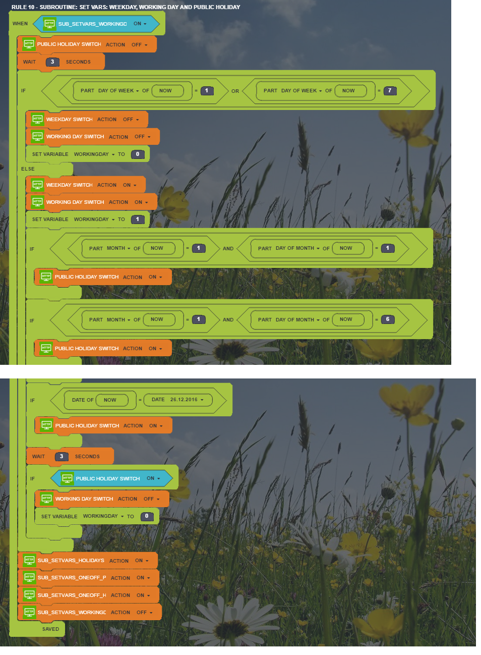

This is an example of one of the variable/switch-setting subroutines. I've just included part of it but you get the idea. Noteworthy here is the 3-second wait after initialising the public holiday switch state. This is because, if you change the state of a switch and then change it again in the same rule, the second change will fail to take effect unless you insert a wait of a second or two.
At the end the rule invokes some more subroutines for holiday dates, one-off days off and so forth, and then sets its subroutine switch back to "off".
This subroutine is invoked from the reboot detector subroutine in case of a reboot/disconnect. It's also run from my "Master Scheduler rule". I was a bit tired of the schedulers not working reliably, so I set up a rule that runs every minute and use it to do my own scheduling of the variable/switch-setting rules. It also serves as a gateway for the reboot detector - it checks the variable and switch and runs the reboot detector subroutine if needed. The reason I did this was that, in the event of detecting a reboot/disconnect I immediately run all my variable-setting routines to restore the box's values, and so I want to skip over everything else in the scheduler (otherwise you can't control the sequence of execution). If we had proper functions that return true/false then I could do it rather more cleanly.
It's a bit messy and it's all still a work in progress.

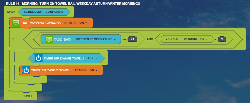

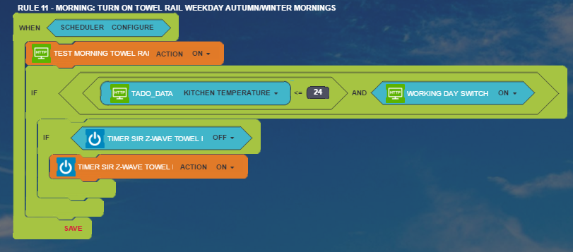

Here's an example of a run that actually does something :-)
It turns on a towel rail at a set time in the morning if it's a working day and if the temperature is below a certain level.
So, all that infrastructure to do something rather simple...

I'm a little interested. Why do you tests the temperature against a virtual meter instead of directly against the temperature sensor?
Sorry, duplicated.
I don't have a temperature sensor! Unfortunately I can't connect my Tado thermostat to the Zipabox right now (as far as I know). Nor can I query the Tado via its API from the Zipabox (a major omission in the Zipabox, by the way - we need HTTP Requests!) So I do something rather roundabout: I have a Google App Script which queries the Tado every 10 minutes, dumps all its data into a Google Sheet and then passes the relevant bits to the Zipabox's virtual meter.

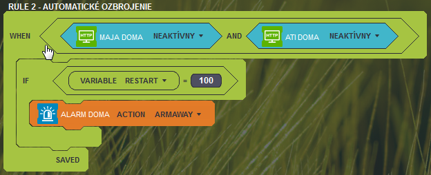

Guys, just to check that I start to follow you correctly, every rule should be extended with the variable (ideally) so the rule will only start of the system is complete and not before.
So what I did is that I extended my simple automatic alarm rule with the variable that was mentioned by henry (restart rule). If i understand correctly this rule will now only start if the box completely restarted.
Is this the right approach?
I use two variables.
"Restart" who stops initiating of the restart routines until it is a restart. This will be reset to 100 as soon the restart routine starts run. This routine starts the first of 6 restart routines by a virtual switch. Then they are started one by one by virtual switches in a chain.
"Operate" who stop all other routines except "restart routines" from running. This will be reset to 100 as the last thing in the last restart routine.
In the routine you show here you should change the "restart" to "Operate". That's all.
Henry's rule (which I've copied) initially sets the variable Restart_Detector to 100 (the first time it runs). If the Zipabox then restarts, the variable will have some value other than 100 (let's say 0). I would imagine it would be always 0, but perhaps Henry is playing it safe, in case the variable gets set to 1 or something. So:
- 100 = Box has not restarted
- Not 100 = Box has restarted
Maybe there's something more to Henry's rule that I didn't understand. He'll have to clarify.
So the idea is to set up a rule which runs every minute, to check the status of this variable, and to reestablish the variable/switch values if there has been a restart. Once that has been done, you can run your rules as normal.
I think what Henry has is a switch or variable called something like "Variables Set Correctly". If the box is found to have restarted, "Variables Set Correctly" is set to "off". Then he triggers some rules to set up his variables and switches again. And then he sets "Variables Set Correctly" to "on".
Then, in each rule, he will have something like:
if (Variables Set Correctly)
Do rule stuff
Which deactivates every rule depending on whether the system has been correctly initialised.
Some of that.

Here's an example of something you can't entirely fix after a reboot. In the Zipabox, sunset and sunrise are one-off events. You can use them to set a variable or a switch so that you know if it's daytime or nighttime, but if the value of your variable or switch is deleted, you're screwed. There's no way to recover the information. (That's why a "sunset time" and "sunrise time" constant puzzle piece would be very useful).
I have a rough-and-ready rule that corrects the "daytime" setting if the time is outside the time ranges that vary with season and daylight saving time (between 21:45 and 6:45 it's always night here, no matter what time of the year it is).
But if you're trying to track people's comings and goings with a movement sensor, there's no way to recover that information.
However: my experience suggests that as long as your box doesn't restart (if it just disconnects from the cloud momentarily), the variables will regain their old values on reconnect, whereas switches will get reset and *will not* regain their old values. Zipato say this is fixed in the new firmware, but I can't verify this yet.
So, for more reliability, I would use variables.

Yes, his idea is to prevent rules from running if the variables/switches that they depend on are not set up correctly, so that they don't do anything stupid.
(I'm not Henry's spokesperson so he'd better correct me if anything I say isn't accurate!)
Absolutely! (Y)

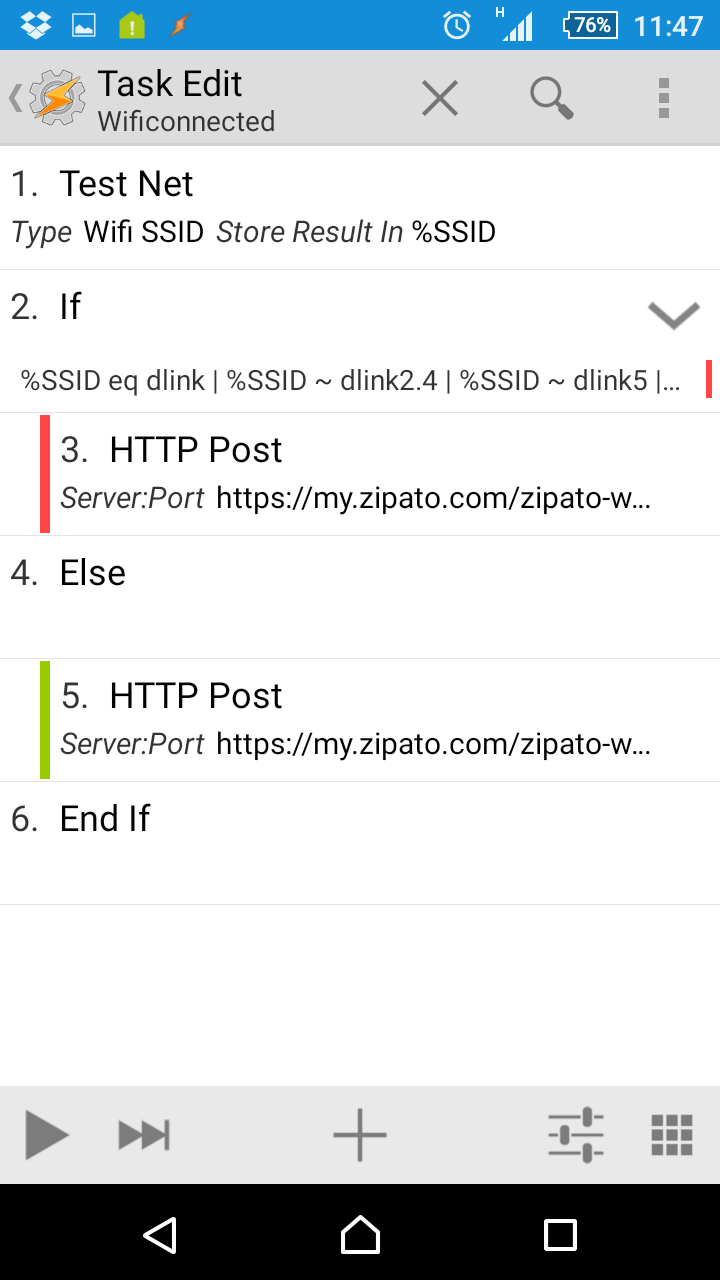

David. I now testing the following:
1. i have a profile in tasker that when
connected to home wifi it changes the state of the virtual sensor to on
and if not connected state to off (via tasker http post). As I mentioned above, this is not 100%
working all the time so based on your suggestion I have
2. a simple recurring task in tasker
that checks every 5 minutes if Im actually connected to home wifi and
if yes, changes the state of the vistual sensor to on (meaning Im home)
and when not connected, sends a signal that im away. This way even if
task 1 is failed, zipato no later than 5 minutes will receive a change
of state of the virtual sensor.
Obviously I will need to do the same for my wife. Will know more in a couple of days...

Ok. So I have 2 profiles.
1. profile checks a wifi state if the wifi is connected to my home or my neighbour wifi router. If yes, it will send https link to zipato virtual sensor ending with 1 (active). Exit task is wait 10 minutes and then send https link with 0 (inactive). As this profile did not work 100% correct, I have created another profile which simply runs every 10 minutes.
2. attached printscreen. First the task checks the current wifi ssid and writes it to a variable. Then if this variable equals of any of the wifi routers name (I have 3 different networks at home + 2 of my neighbours have) than sends the https link with 1 (meaning Im home). else it will sernd https link with 0. This way if my 1st task fails, no later then 10 minutes it will send info to zipato that i left home.
Apparently there is also a solution in tasker to simply wait for the response and if no response received, loop this as long as the response is received, but i dont know tasker that well.

Hi Adrian, Im sure there are various ways to do it to make it work. I even read on the other topic that there is a way to actually wait for the response and if no response from the server, go back to sending the link.
Unfortunately Im not a programmer neither aIm good with tasker. And unfortunately not I have time to play with it.
At the end of the day this works flawless. The sensor is not set to 0 after 10 minutes as the exit task will only go live when disconnecting from the WiFi network. Since these two tasks are live (for me and also for my partner), I can rely on automatic arming/disarming 100%.
