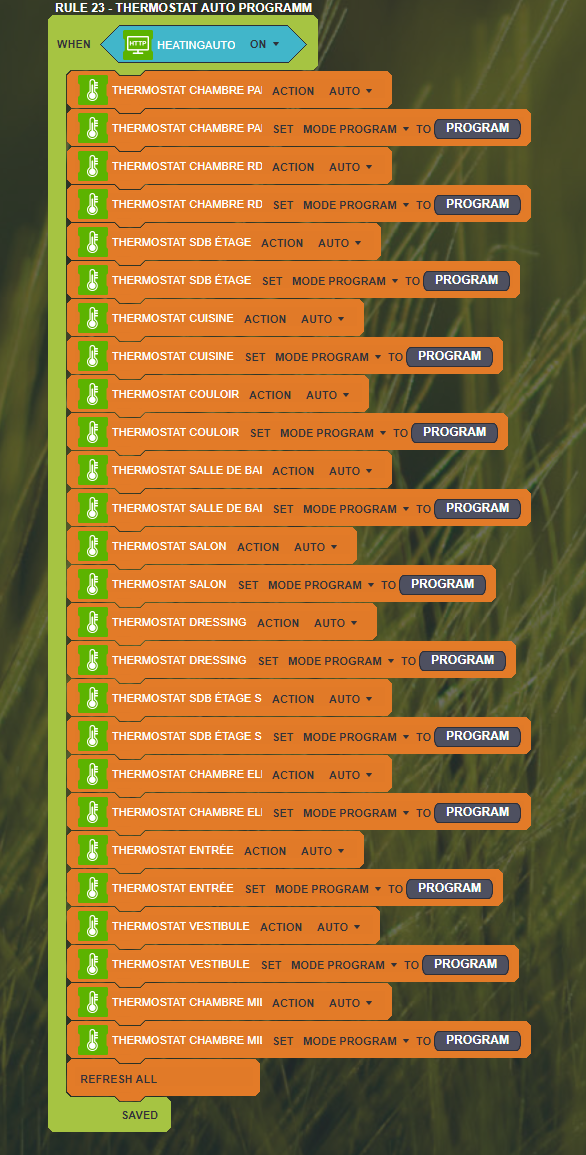

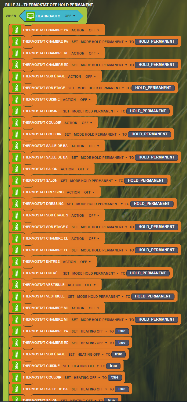

does someone know how to address the different capabilities of the Virtual thermostat in a rule ?
I would like to change fro instance the "away" period or the target temperatures...
please see some examples..
would also be nice to make a group of these thermostat... for obvious reasons when you look at my stupid coding...
Thanks for your help
Well, you have a couple of zones for sure. Use the scene. Set up 2 screnes and include all your thermostats in there. Then the rule only need to fire the scene not all the thermostats.
