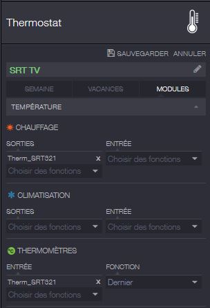

I got the same problem and I spent a lot of time to understand and get the good settings of the thermostat itself (Hortsmann SRT321 with SSR303, linked together) and the virtual thermostat (VT).
You should trie this VT setting (see attached file). Zipabox can't handle with the parameters "Input" and "Output" device to be the same. In my case I set up the "Output" with SRT321.
For the thermostat SRT321, I set up the wakup time every 30 mn (It's important).
If you want to modify the T° manually, you can do that by changing the T° in the VT => the program mode should shift in "until next" mode.
If you modify the T° in the thermostat manually, it will run until the next wakup time and then the VT will handle again the T° regarding the program.

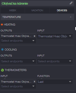

See, this actually proves that not every time is zipato in fault but sometimes it also is dependent on the device you use. For example I have this MCO thermostat https://www.koti.sk/p/624/zwave-plus-mco-termostat-na-ohrev-vody
and believe or not, but even it has no descriptors it was included on the 1st try and works flawlessly. I have it as input, output and thermometer and have to say it is a truly proessional solution without any further need of input by zipato. Although the parameters are not changeable in zipato (due to descriptor missing) as this device supports parameter settings via its own display, it is no problem to adjust.
Works like charm from day one. and obviously without any wakeup interval...:) instant change...
