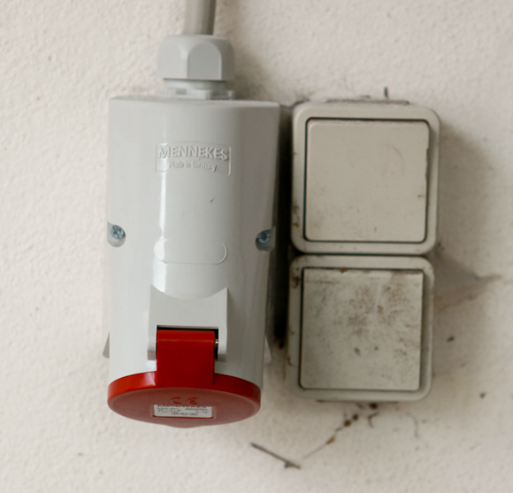

Hi all,
I wanted to hear if anyone knows a hardware sensor that can handle a three-phase wall plug like the RED ONE in the picture, it runs from 1 single cable with 3 phases in total. 5 wires in total. N - Grund - 1 - 2 - 3 fase. I wish to monitor my Grund heating unit and it can pull up to 6000w. I got the Heavy duty switch but i can only handle 1 phase. Dont tell me that i need to split it up using 3 relays with energy meters in it, if that it duable at all.

I have that one - but it goes up to a maximum of 2 phases depending on model - i have not found a version with can do 3 ) 5 wires in - 5 wires out :)
