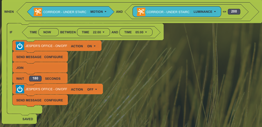

I have attached a rule of mine, that looks almost the same...that is working...8)
That should work...have you remembered to sync your rules?
The rules engine run in the cloud, you need to download/sync the rules to your Zipabox, when you have made them/made changes to them!

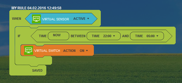

Hello Thomas,
I have attached an example Rule, I tested it and it works. I used Virtual devices but the principle is the same.
As Jesper suggested please don't forget to Synchronize Rules with the button on the right side of your web UI.

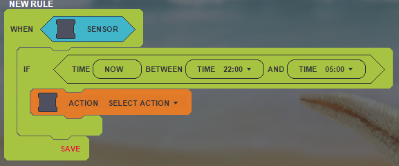

Hello Thomas,
