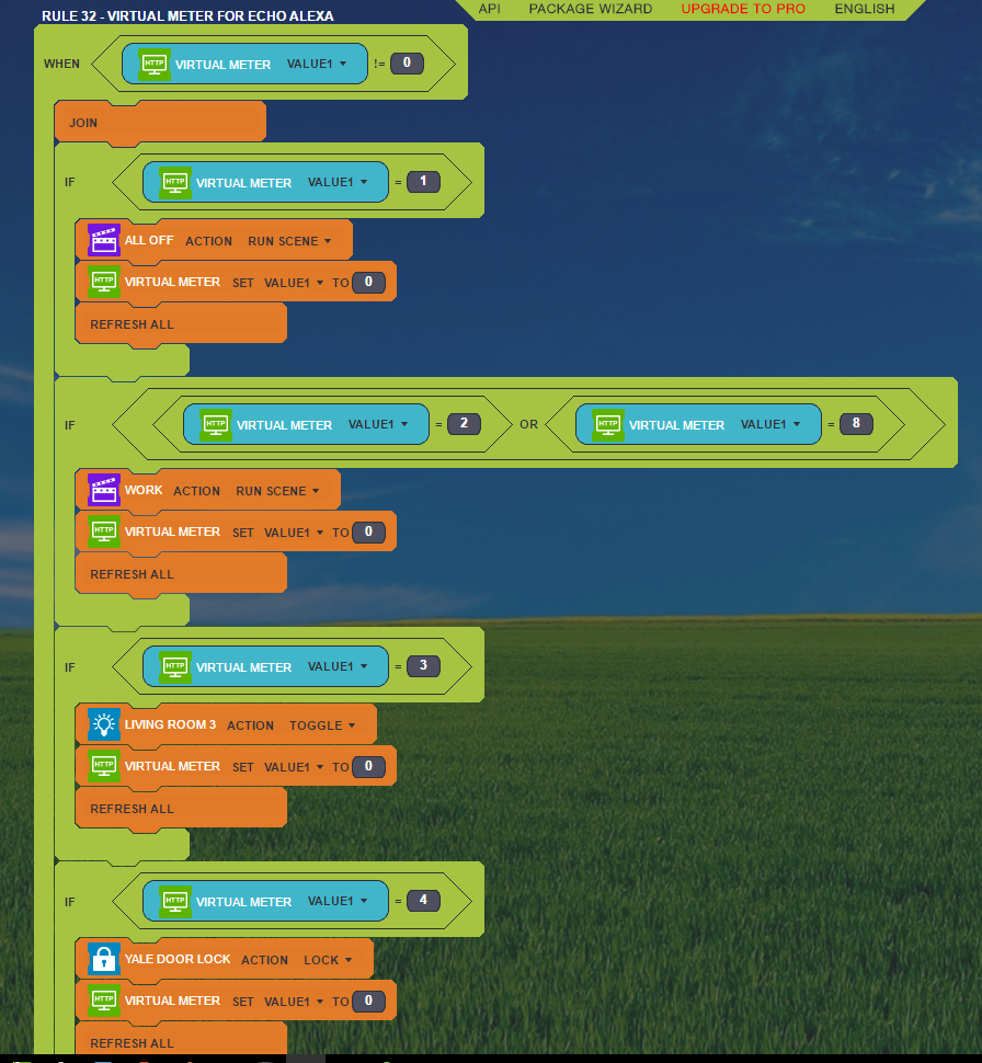

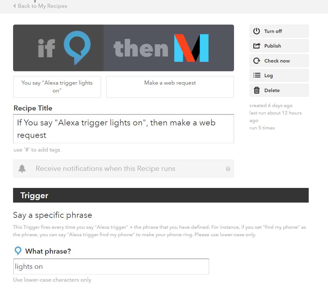

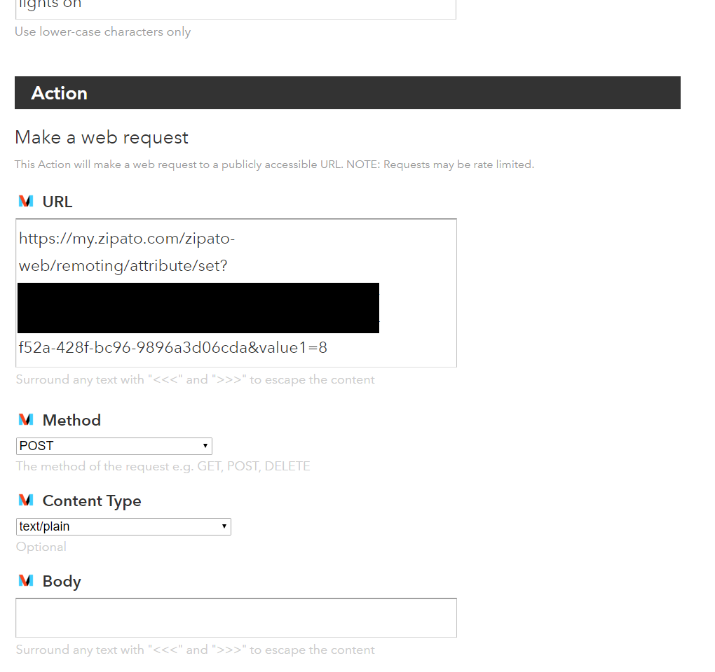

Hi Magnus, I am not fully understanding what you want to achieve. I have attached a pic of a virtual meter and how I use it for IFTTT triggers in Zipabox. If you wish to run another rule upon one triggered, just use a another virtual switch or meter. In the rule set the switch to on, then have another rule activate when this switch is on.
What do you mean "you can not figure out how to use the scenes manually?"
