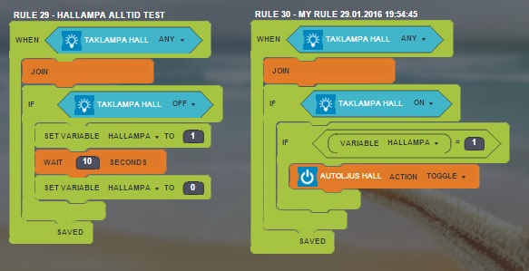

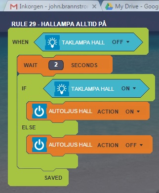

I have created the following rule to enable toggling a switch. But it doesen't work. Should it?
toggle_quick_on...
Change the when state of the switch to any. you can also use command send message to test the rule
Thank you for the tip Attila. I was able to confirm that the rule above indeed didn't work. This seems like a bug to me.
Developers please have a look at this ok? I think the catch here is that this can't be done with one rule.
Though, i was able to solve this with a work around (see attached picture).
