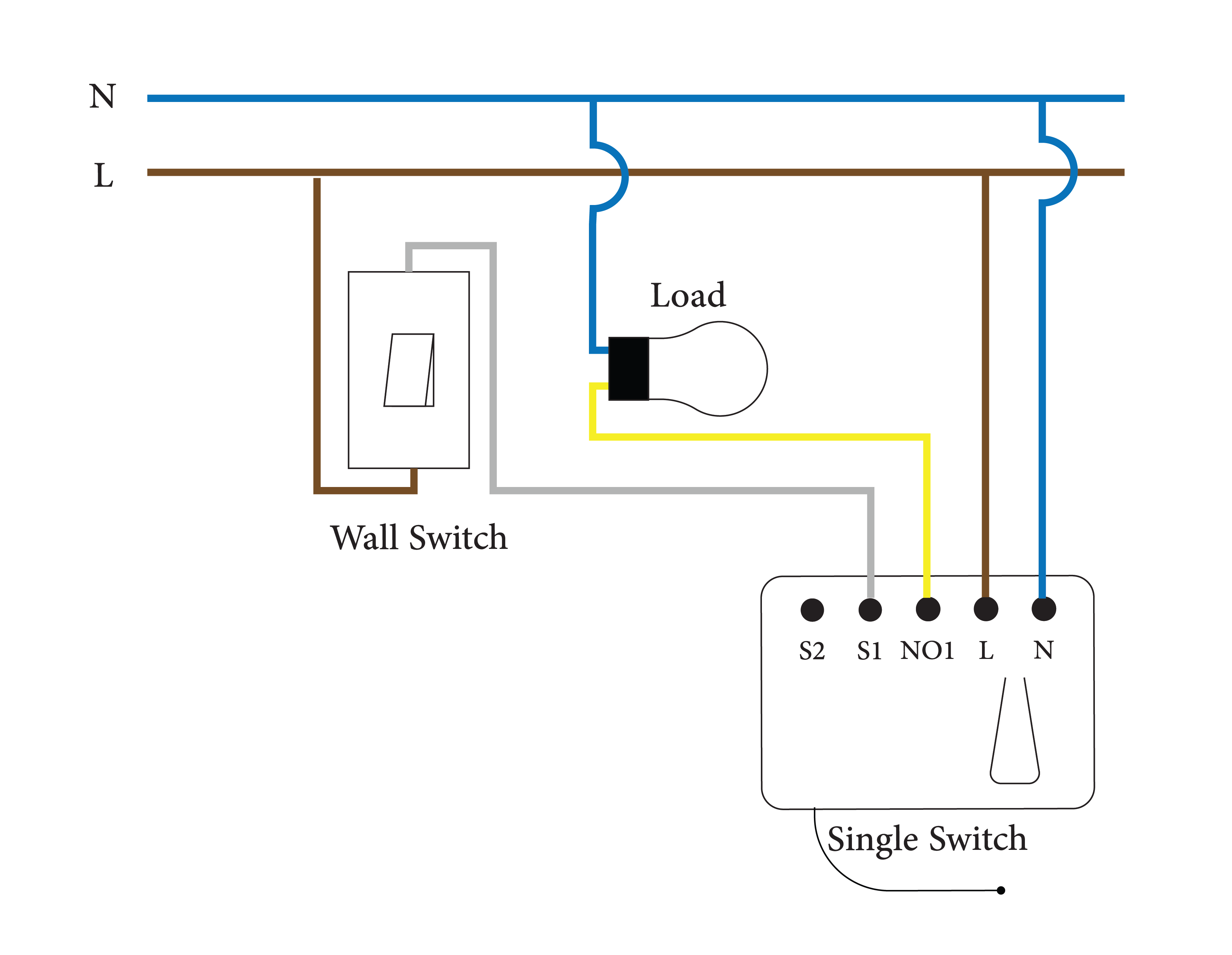

I did wiring MM switch like on attachment. When I use touch switch z-wave part working fine but I couldn't put on/off touch switch physical.

Of course not. Touch switches do not work with Relays. Only exception are some quality touch switches that have Neutral connection as well.
Could you give me name of touch switch which one compatible?
Hi, Lanbon products were tested to work with relay switches.
